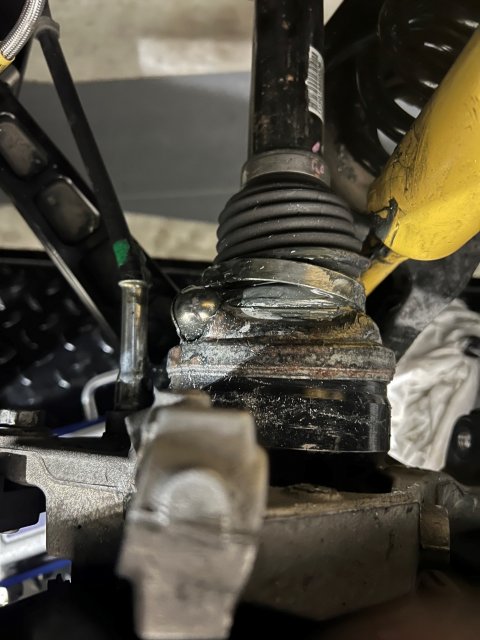

But I do believe that the real cause if this breakage was due to some very violent wheel hop at a no prep event the day before.

Cage is probably the weak link on any axle, some more than others. Years ago I broke a DSS 1400HP axle, and it was the cage that shattered. They replaced it no questions asked and said they had gotten a batch with the wrong metal used for the cage. Whatever was used was more brittle than spec.

My thought is you never have wheel hop they will last a long time. The hop I had right after putting a pulley on mine would have destroyed both axles if they would have been stock. Jon had a little wheel hop and broke his in the diff. Sheared the shaft off

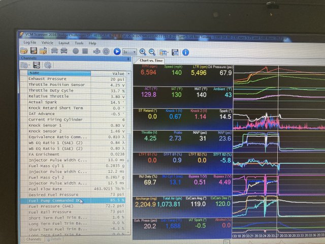

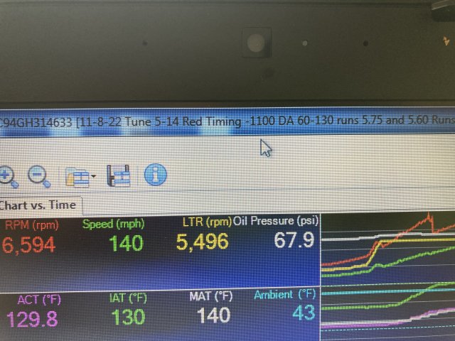

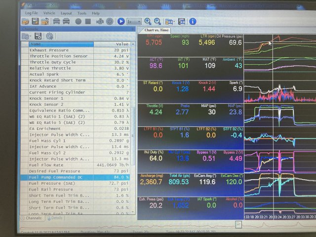

I think if you did the fuel line mods Ive been suggesting your current fuel delivery system would keep up without going to a BAP. Mine keeps up to much more No BAP . Yes, my injectors are bigger but fuel flow is fuel flow to the injectors the pumps have no idea how big they are. My fuel pressure is set at 73 psi and the twin 295’s no BAP keep up with that with a bit of pump duty cycle left to spare. Could probably go to 75-76 psi but there’s no need to as I have injector DC left to spare yet because of their size. I’m pushing at times over 24 psi and 2350 Aircharge and I don’t think my pump DC has been over 85% yet. This was just in negative 1100 DA, last hurrah of the year, spin city due to cold roads but still managed 5.50 60-130 times and a 11.3 at 143 1/4 with a super shitty no grip 2.2 60 ft (M6 remember so having a trans/engine tune to help launching is all in 2 feet unfortunately not PCM and TCM) Its winter, send me your fuel rails I’ll do them for free and you take care of the restrictions in the beginning and end of the fuel line by tank to engine bay and I bet you end up with pump to spare again. Or your money back lol.
