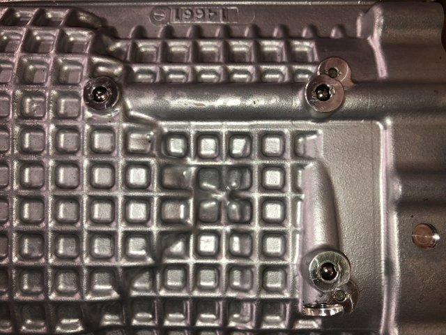

#71
Now look on the belly of the blower, there’s 2 tiny vent ports under there, next to the seal balls. There connected to an area between the pressure seal and the gear case oil seals, any oil that gets by the seals will vent out through these 2 vents. The sealed gear case vents to this area as well through a small hole in the hollow driven rotors shaft, the bolt that holds the drive gear on has a tiny hole drilled through it and that’s how the gear case vents to atmosphere. That why you always want to store these blowers level not on end, or on their sides, upside down would be ok. 8CCC92FF-9D45-4F7C-9588-C4288AA63B94.jpeg 55D5B432-2030-4331-A346-C59E577ADAF8.jpg
