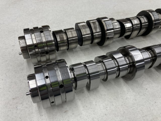

Looks about an inch longer too!
haha
Optical illusion from camera angle. Every dimension short of the lobe geometry is exactly the same as the stock cam including the length to the thousandth. After FAS screwed me with a bogus ready to install inlet plate I QC EVERY part I get from now on. Lobes you can noticeably see the duration difference, from egg shaped lobes to oval lobes. 5DB6B772-6DB0-4914-A8B7-71E91682C71E.jpeg

Optical illusion from camera angle. Every dimension short of the lobe geometry is exactly the same as the stock cam including the length to the thousandth. After FAS screwed me with a bogus ready to install inlet plate I QC EVERY part I get from now on. Lobes you can noticeably see the duration difference, from egg shaped lobes to oval lobes. View attachment 38748
Just messin with ya bud... great tear down, sucks to see the tranny falling apart.

Yeah that cam is WAY different. Explains a lot of what I've seen, and felt, in the Redeye motor upgrade on my car.

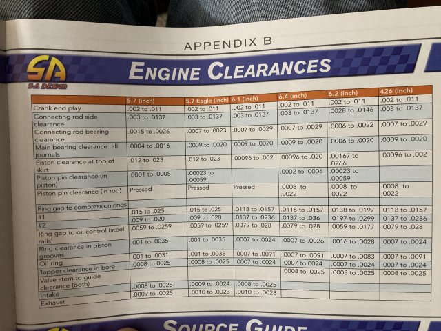

Take a look at factory ring gap data in this chart, mine where all right in this range. Even more troubling look at a 6.4’s top ring gap data, .0118 to .0157”. No wonder when people put pro chargers on them and push them a bit to hard they pop pistons or fold rods over. I don’t think the pistons and rods are the weakest link in these engines, I think the tight top ring gap is starting the trouble and the piston is getting stuck up top when rings butt hard and the rod is yanking the bottom off it and the rod is taking the blame as being the weak link when it breaks on the next up stroke. I see evidence in my engine, top of the bores some ring scuffing marks are seen which most likely was from them butting as this was seen in the tops of the bores of 2,7, and 8, the pistons whose rings showed signs they where touching intermittently and 7 popped a brow and ended up with excess leak down.

Agreed. Ive been saying the same. Its not due to weak pistons, its due to a crazy tight ring gap. When I did the drop ins in my Ram, out of curiosity I measured stock. I thought I had measured .011, but it might have been ,015

The problem isn’t the top ring, it’s the 2nd ring. It’s been suggested that the 2nd ring gap is too tight, and the pressures exerted on it are forced up to the bottom of the top ring which is the wrong direction, because there is next to no material above the top ring.
When you build the race motor I think you open the 2nd ring even more than the first to help prevent that.
