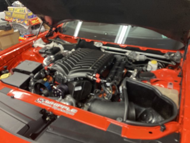

On to see if the 3.8 will fit under the stock 16 hood. Some readings on the internet say it won’t .
Yes!! It fits!! But unfortunately not with insulator spacers :(

Next hurdle, without spacers blower snout is hitting block keeping it from mating to heads and sealing on gaskets. Good thing in look for this stuff. Hard to see it, I wonder how many are going to get tightened down without seeing this and have intake leaks and stress out into the blower housing!??
71798610707__54A98E89-A293-47F3-9019-3D827626A5FE.jpeg 71798613886__DFBD883E-3FF4-4192-A087-66B7EC710ABE.jpeg 71798631663__5C71F712-B1B6-4407-9D8A-ADA5A394DDE5.jpeg IMG_0604.jpeg IMG_0602.jpeg
Surgery time
A little paint and like new again

Odd it hits. Did you let Whipple know? Sure looks the same as gen 5, whats different?
Yes, I emailed them pictures, snout on the 3.8 is a little different, it’s got just a tad bigger inlet area.
