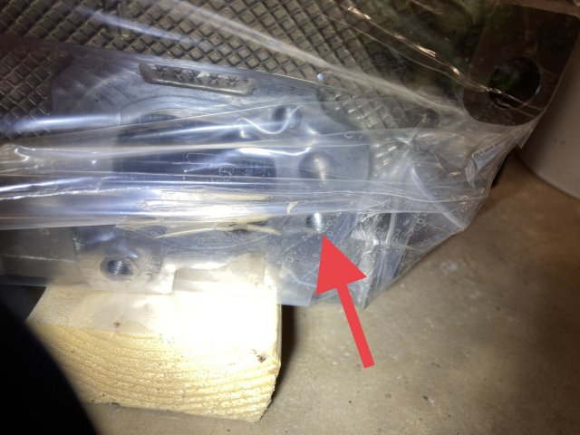

what's the purpose of the tube - some kind of extra structural support?

It goes to a port on the head that is not machined open on the 6.2 heads but is on the Apache heads from what I remember JBA telling me. It’s only on the passenger side header. I don’t remember 100% if it on the replacement they sent me, it could have been as I remember having to edit like 6-8 weeks on it as it had to be made. At the time I didn’t know it was coming from that tube, I thought it was from the main tube to flange joint.
See the hole there at end of arrow? It’s there but not machined deep enough to go into anything. It’s on the Direct Connection Demon heads I got too.

It has a bolt on each side of it, the head was drilled and tapped for a bolt there but the stock manifold does not use this other bolt hole. There’s 9 bolts on this passenger side header verses 8 on the drivers side and stock manifolds as well. That 9th hole is used to mount the dipstick tube to only on the stock set up.
