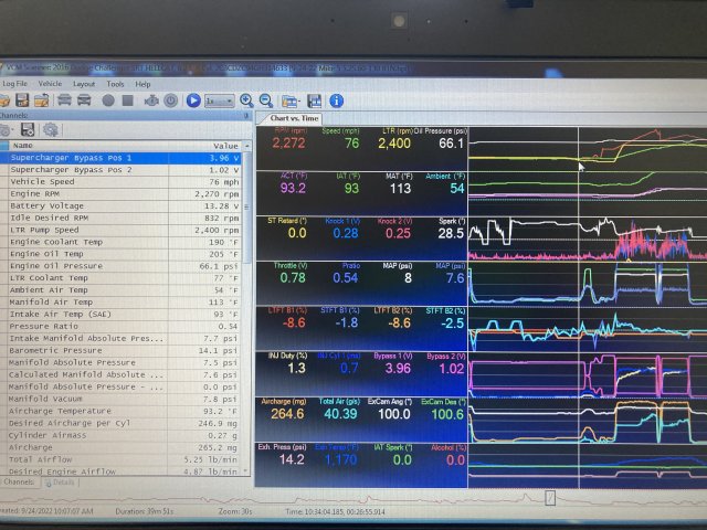

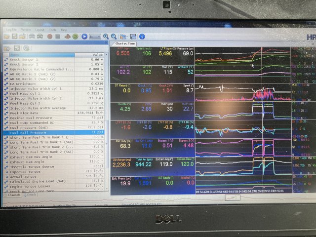

I did some dialing in of the injectors last night, in less than an hour had idle at 0% LTFT and cruise within 3-4 and WOT (one short hit) was +6, then my laptop battery died which sent me home :( I think we’ll have them dialed in before the weekend is out. I have a work related party to go to tonight so no playtime this evening to finish them up. Most I saw injector DC wise was 45% and 12 milliseconds at 5500 rpm, pump DC never topped 79% with a new set point of 78psi at WOT, 56 all other times. Looking good so far. 👍

Injectors pretty dialed in now, Still a bit of fine-tuning to do to get them as close to zero as possible but they’re runnable as is. @jonx96 desired fuel curve working well, pump system kept up even on a “extended” run.
