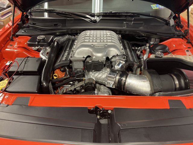

Ready to ROCK!! Now I just have to wait until later as it’s 96° outside. I ain’t going out in this shit no matter how much I want to hear it scream lol

Looks like a little over enthusiasm on the top right, hope it doesn't introduce much turbulence when it hits the lip...
The over enthusiasm was to open it up enough to take a 108 which will be the next dyno test :)

^^ understood that, just noticed the over removal right at the edge where it mates to the billet plate. Right top appears to be maybe a 32 further than perfect mating...saying it could cause turbulence in an otherwise smooth stream.
I was told with my baby tune that the fuel rails are sufficient for my use. I'm right around 780-790 to the rear wheels. This is on the stock single pump.

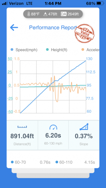

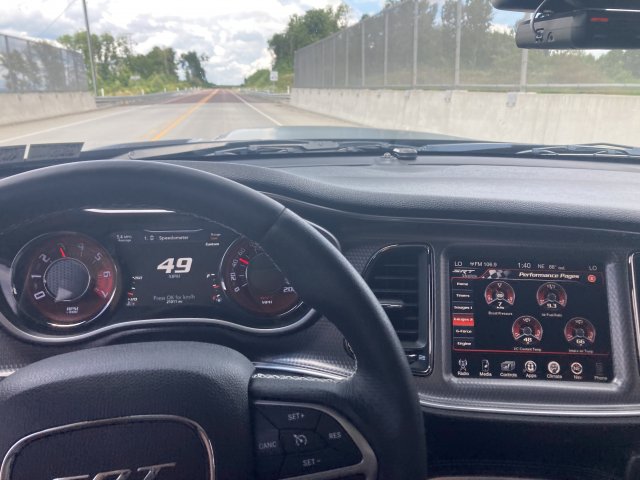

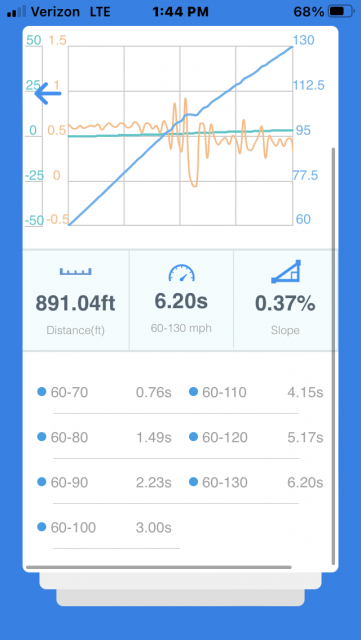

My savior is my killer chiller is still working great and keeps the IAT’s in check even in this 90F heat. The blower with the pulley combo would never survive long without it.
And she still performs well even in +3000 DA.
Notice the time on the HMI and the run time. These pictures taken right before and after the run.
The squiggly lines in the top of third just before the shift was the tires breaking loose at 100+, PURE FUN!!
Now if I could just get these pulleys to survive more than a month LOL

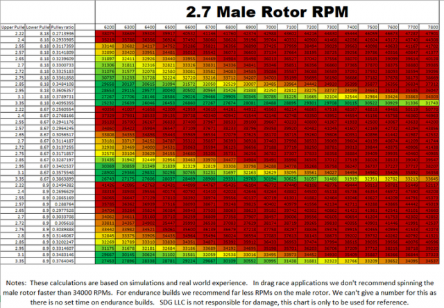

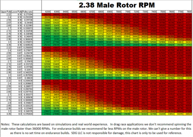

That's good info and lines up with what I'm being told from people that KNOW. Heat kills these superchargers and SDG also said it's never the bearings.
There's one typo in there I think, ir I'm reading it wrong but you divide crank pulley diameter by upper pulley diameter then multiply by shift rpm, then 1.6 to get the male rotor speed.

SDG just posted the rotor speed with different pulleys set up on their facebook page this weekend. Shows green to red in speed
60,959
212,976
They did both blowers also 2.7 and 2.4
We have a thread on that. I will add it to that thread

Tag me in that please I may have missed it.
Post it in this thread to if you would please good information to have here as well

Mine has been in the red…. When I bought it one of the shift points was at 6800. I wonder how long my blower will last. I have been debating if it’ll be best just to get a whipple. Or send it out for a blower plate and have it inspected. Unsure. Seeing those charts are scary. But mooo powa!! Spin it to win it!

My gut says it's cumulative. Spin it hard a few times and probably no big deal, but repeatedly and things start to go south. I also wonder how things like billet bearing plates and ported snouts effect the chart data.

Neither should be you are still spinning it that many rpms

I'm reading it's a combination of RPM + Heat. More air = more pressure = more heat.
