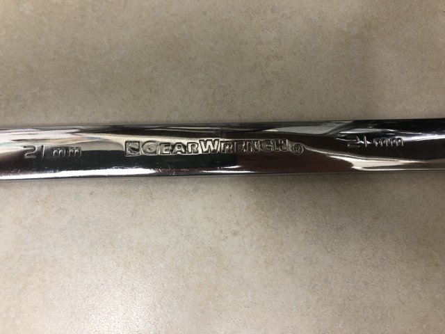

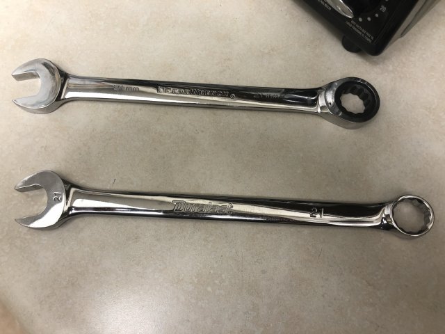

I can take a pic if needed but I bought it at NAPA auto parts here local.
It's not a pivoting head, it's a straight wrench. I have a regular combination 21mm wrench to brake the bolts loose then I put the ratchet one to work.
The wrench will not get trapped if you take out the vertical bolts first so you can slide the diff forward as you loosen the horizonal bolts.
Obviously the DS has to be off at the diff to slide it forward. ( on a floor jack )

The name on it is "Gear Wrench" from NAPA auto.
The regular one is Duralast from Auto Zone.
