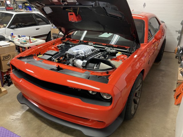

Everything came out alright, let’s hope start up goes as smoothly today 😂

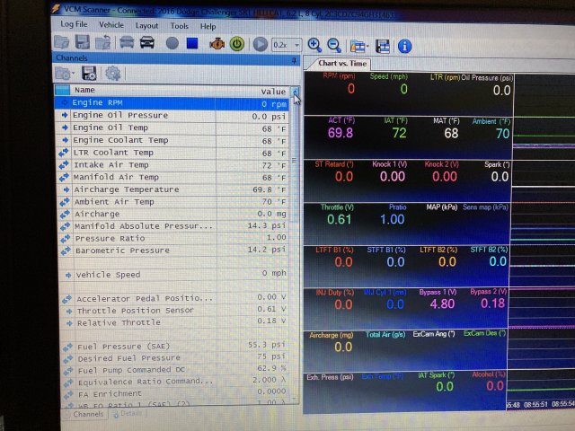

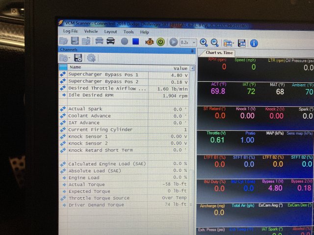

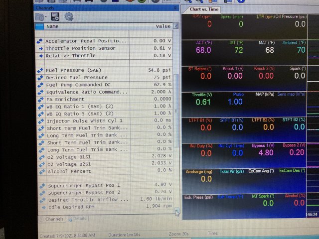

Car is ready, fuel swap complete, 1/2 tank fresh Sunoco 93 in the tank, startup tune loaded, laptop on charge, all vitals look good, hoping to push the button this afternoon. 🤞

So far so good :)

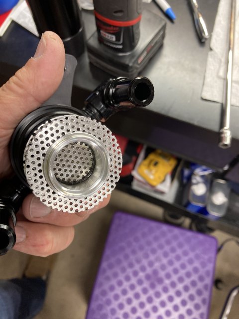

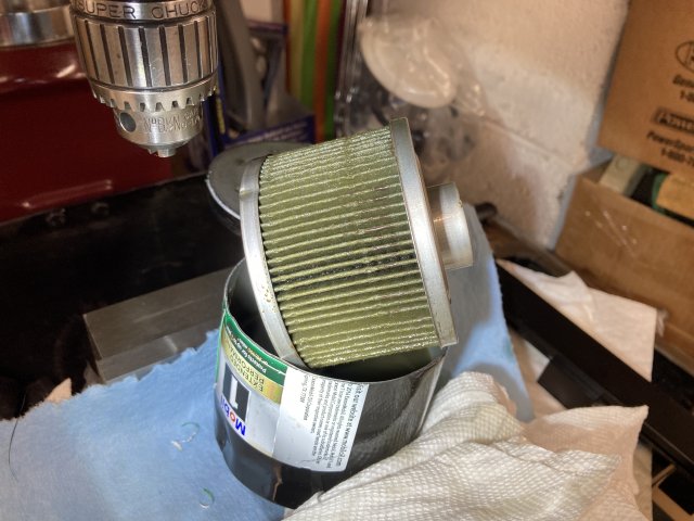

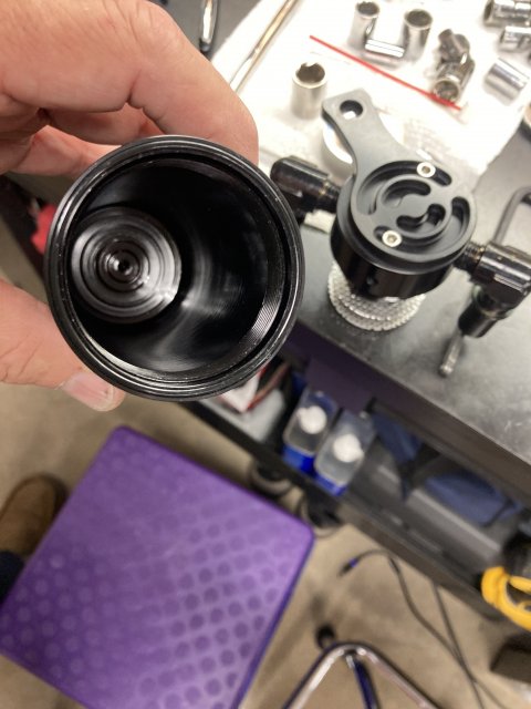

Tonight dumped the oil and changed filter again and refilled with 7 Qts of BR40 this time, 10w40 oil. Magnetic dust on the pan magnet, that’s ring break in particles most likely, nothing on the magnet in the oil cooler line and filter pleats clean. I saved filter pleats to send out for analysis 🧐 , gots ta know lol. UPR catch can spotless, looking good so far. Put about 50 miles on her today, tomorrow lean on it a bit harder and longer.

I’ll have time to make up some magnetic oil plugs this week and pm all who have expressed interest in them when their ready to ship. I think it worked GREAT!! All that stuff would have passed through the oil pump before making it to the filter, That’s why nothing was seen in the filter, it caught it before it got there. It’s so magnetic the wrench sticks to the hex on the plug on the outside of the pan lol
