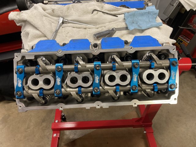

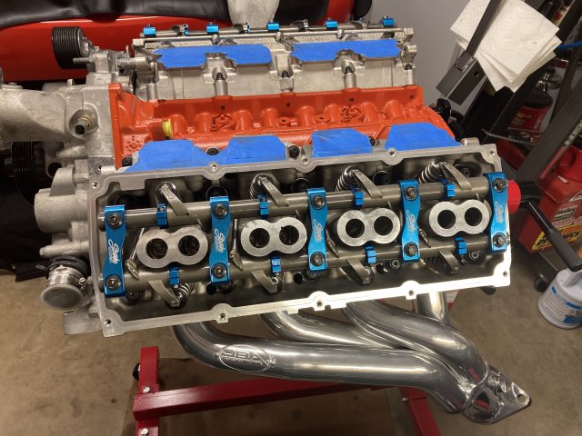

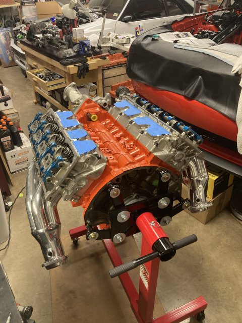

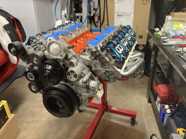

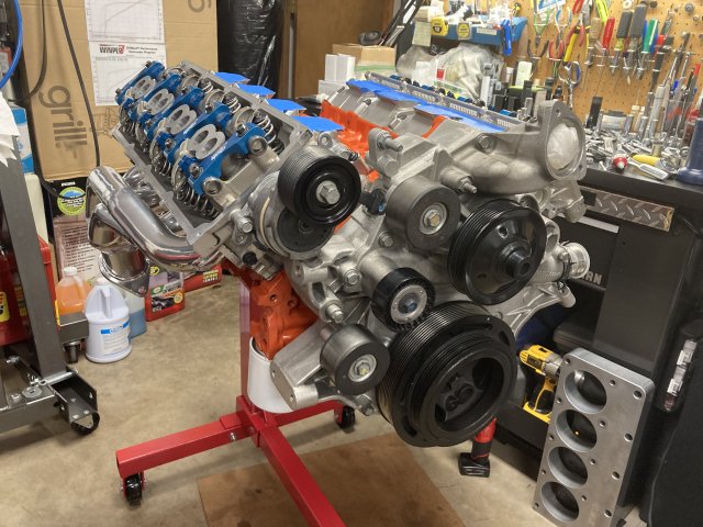

Long day today, just got done eating breakfast finally. About ready to come off the stand and see if I can get it up and over the front cowl without taking the hood off. It came out with the heads off, going back in with them on. I’m leaving the oil pan and pick up off for now which will save me about 8” of lift, hopefully that makes up for the heads making it a taller package. I’ll put the pick up and pan on while it’s hanging in the bay then drop it onto the mounts is the plan 🤞

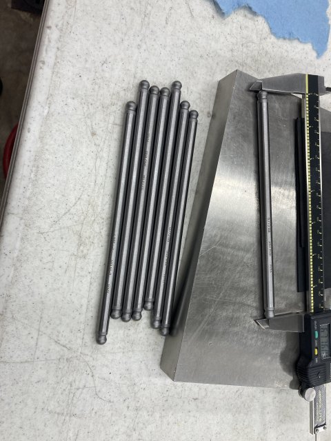

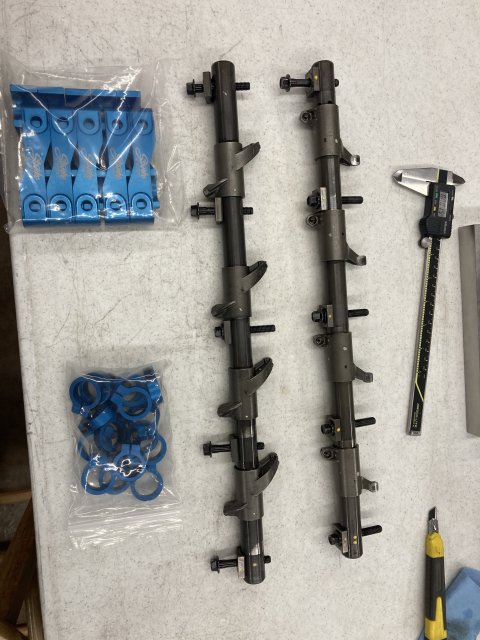

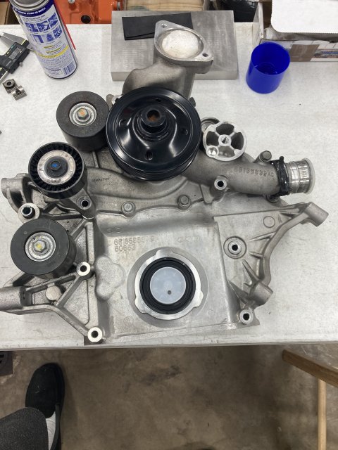

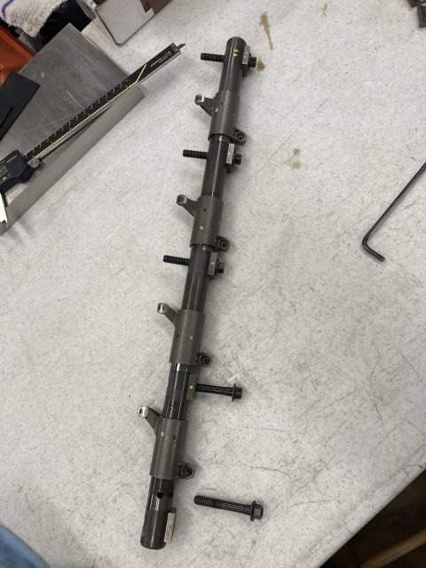

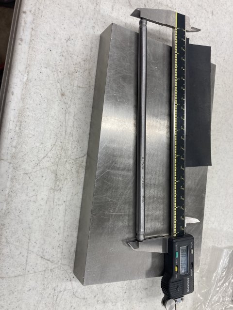

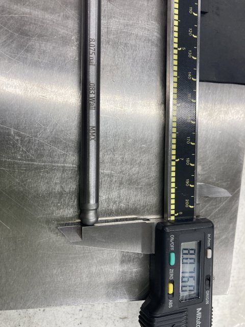

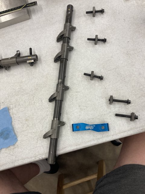

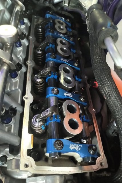

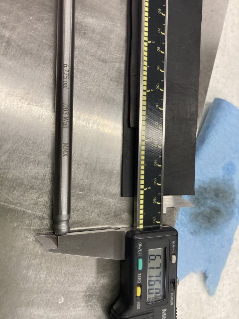

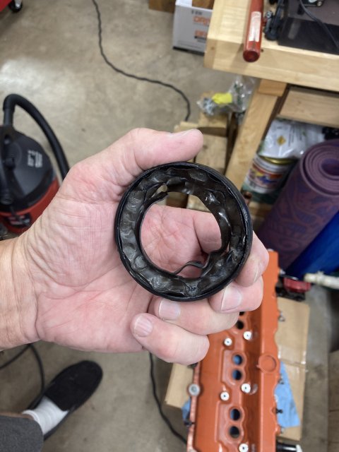

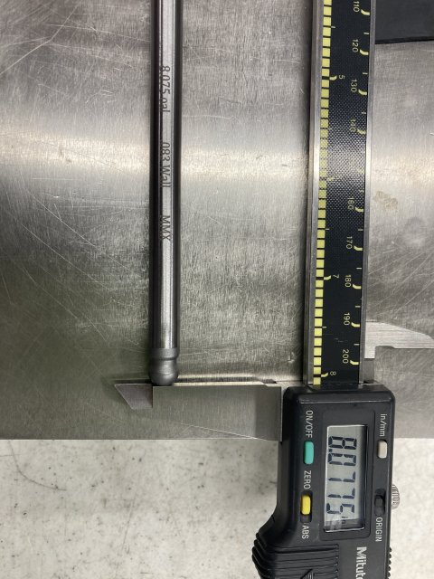

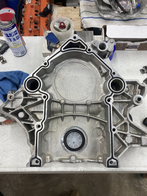

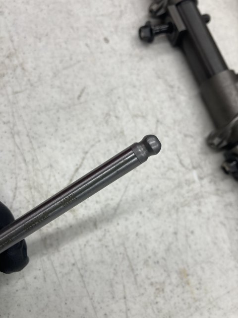

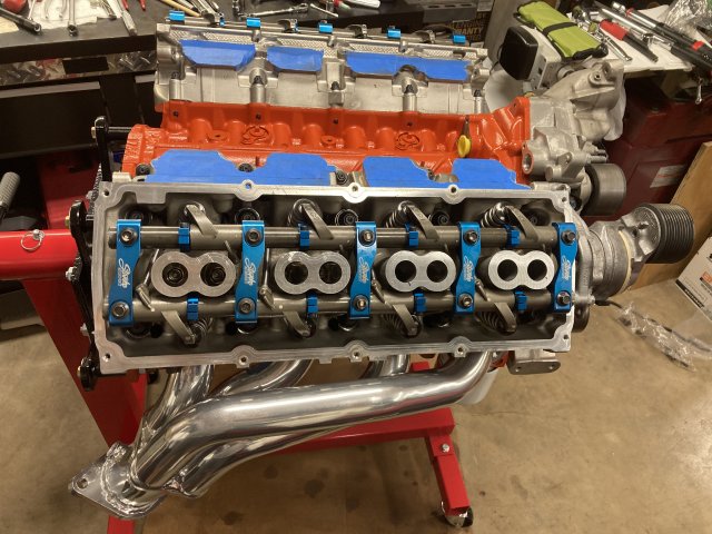

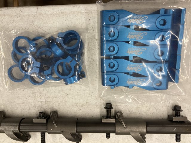

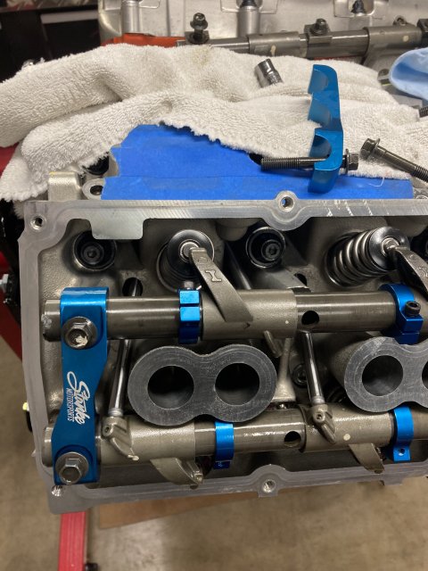

This was today’s happenings. Check new MMX Chromoly push rods for length and straightness. They were about all bang on length wise and perfectly straight, nice stuff. The ends have a 210 degree ball end on them which is supposedly better then offerings from others that just have a 180 tip on them. And disassemble the rocker assemblies to add the Stanky stuff. Replace the front seal in the cover with a new one, original had a gouge in it, had to be from OEM time as it was never off before. Then finally torque the new damper bolt to 229 ft lbs, that was fun, I thought for sure the bolt or the crank threads where going to let loose first and I’d be starting over from scratch, 36B59419-DCB0-4885-89E7-8FA40CFF0181.jpeg 54500C2E-E918-4C6E-8A83-13BD15793C16.jpeg D651B0A8-EB5E-42C6-915C-E8534158E0C0.jpeg E92FFB42-37CA-4500-BF24-3B60307AF452.jpeg 4FAB049C-16E0-4CCB-8AFA-E800F546D707.jpeg F5515B17-4F6B-4880-8DF3-B4C1CB4242F7.jpeg CC15A770-9662-4572-AC87-618A4C96CCBC.jpeg F9B1BA23-9A0C-4E91-9F51-65B4E7CAFF97.jpeg 3102286D-2EE6-4221-AE0A-DFC6263CF3E4.jpeg C8F829DC-5487-45BA-9F6A-1C7F3722190C.jpeg 7708DC09-C530-4AAA-8A69-BA407DBE3A1C.jpeg 01073084-3C3D-4569-924D-579669FBABED.jpeg 07C1AC8A-8D88-4C97-97AE-2A640236E0F1.jpeg 43E7908E-FAB3-4978-BEB2-DEB3DB1D29BC.jpeg 0C4C6DFB-D440-4F68-B2DA-4752E735D8EE.jpeg D3AAF382-E96E-40E2-838F-81D9E03CBA8F.jpeg
that’s a shit ton of pull on them threads!!!
View attachment 47774 View attachment 47775 View attachment 47776 View attachment 47777 View attachment 47778
Looks great!. Anticipation......sooo close. Almost.....there.
