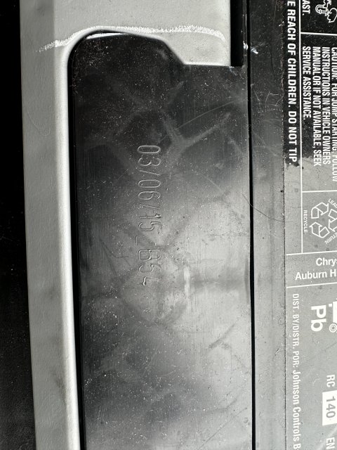

Welp, sad to say it… but my original 2015 factory battery finally ate it. Charger says it’s fully charged, won’t start car. It’s been a good run.
What are the good replacement options? I’d like to go lightweight, but really not trying to spend $800. So what other batteries are out there that are good (regardless of weights)?

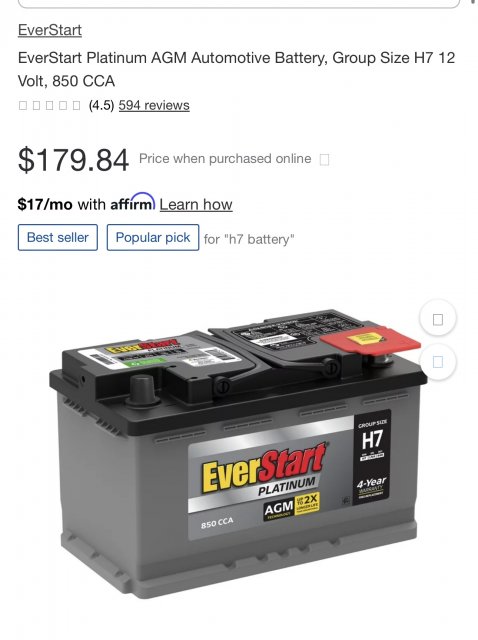

I’m going with an everstart AGM. $179 and made by the same company as the duralastlast and diehard, just relabeled. 4 year warranty. I’ll lose some weight to make up the difference 😅

Walmart battery for the W. Fired right up and idling smoother than it has in a long time. Battery holding at 14volts no fluctuations. I know it’s just idling, but usually at idle it would fluctuate between 13.6/ 13.8
5,499
4,529
With a 4 year no questions asked exchange warranty, can’t go wrong.
