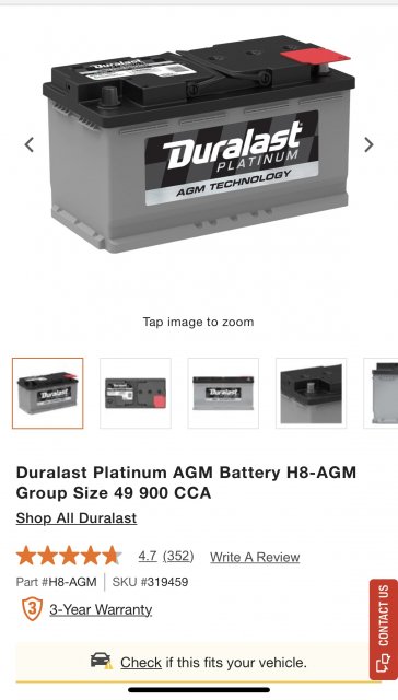

Duralast or similar from local parts shop? If not going for a light weight race battery I'm not sure it matters.
I’ve had very good luck with Duralast Gold and Platinum on daily drivers. Just make sure they’re fresh.

Thread Starter #19
I’ve read good things here about this one:
