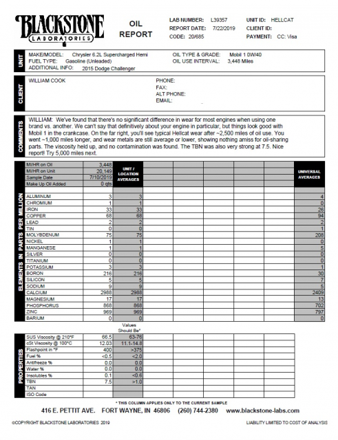

Hope this helps and here is a Sample of oil analyses performed by Blackstone on my 4th oil change:
OK, so lets say my engine blows up. The dealers says it's because the oil was bad and will not replace it. So, I say "prove it" as you suggest. Then the car sits there until they sell it to a junk yard for storage fees. Because they refuse to fix it. Or I have to get an attorny etc etc etc. It's much easier to just do some common sense maintinance. You yourself said that time is a factor in determining the life of oil. Last time I checked no one was offering to pay my attorney fees up front until we win this for sure case.
