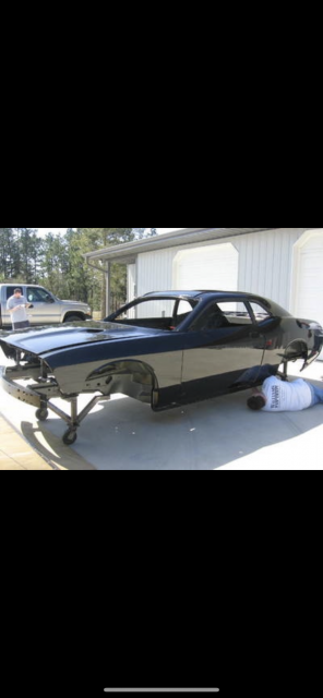

Herman shows pictures of the one he owns that they are using for this build. In this case it is a Challenger body without anything attached. No engine/drivetrain. No suspension. No interior/glass/nothing. They do not have a VIN. It is built with the conversion into a race car intended. It’s how the Dragpaks start out.

If anyone is looking for a “body-in-white” i have connections to get two more of them.
