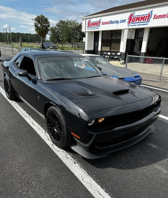

Mine is phantom black. My car has satin blsck hood from the factory though, which looks amazing with the phantom black pearl
Interesting. do you have a picture that shows the contrast in colors by chance?
5,498
4,529
You know how hard it is to photograph phantom black ha

Yep, looks black at night but sparkles greens and blues in sunlight

I wrapped my roof and trunk myself to match the factor painted satin hood. Also got a factory satin black shark fin antenna that they use on the T/As

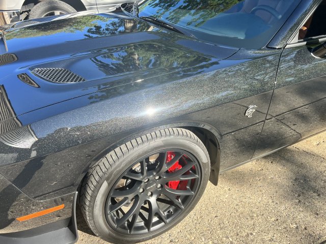

Thread Starter #18
5,498
4,529
Thanks man
Looks great like that. Phantom Black really is a great color on these. Looks like Pitch Black until it’s in direct sunlight. Then it absolutely pops.
5,498
4,529
It’s a 3 step paint job. Expensive to get anything painted that color
