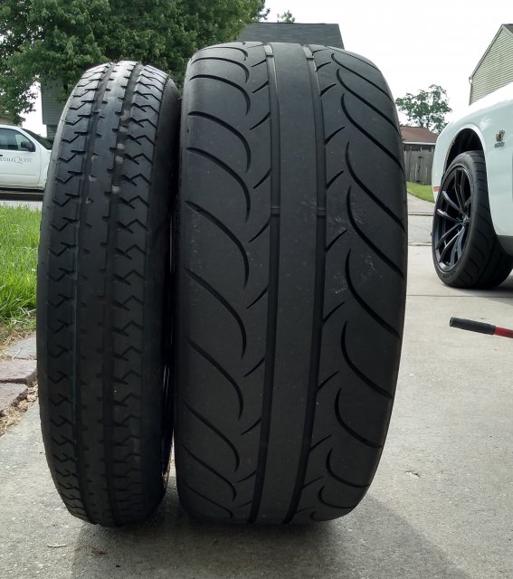

But if you swap out rubber for speed rated tire would it fit in well? Or am I missing something. I'm known to do that sometimes. LOL.
The current spare that I have meausres about 27.5 tall, and I should be able to find a front runner tire that will be the same or close enough. More to follow next week :)
18x6 Racestars with 28" tall M/T radials are good for 150+MPH. This is one more reason I chose the heavier tires for my drag pack. HCs need something designed to fit over the front brakes. If I blow a rear tire I swap the front to rear and put the skinny up front. Easy peasy.
Can I please get an idea on how wide this tire / rim combo is at its widest? I’m looking for a spare that will both accommodate the HC’s large brakes as well as fit beneath the rear strut tower brace I just installed. Looks like Ive got about 8 inches:

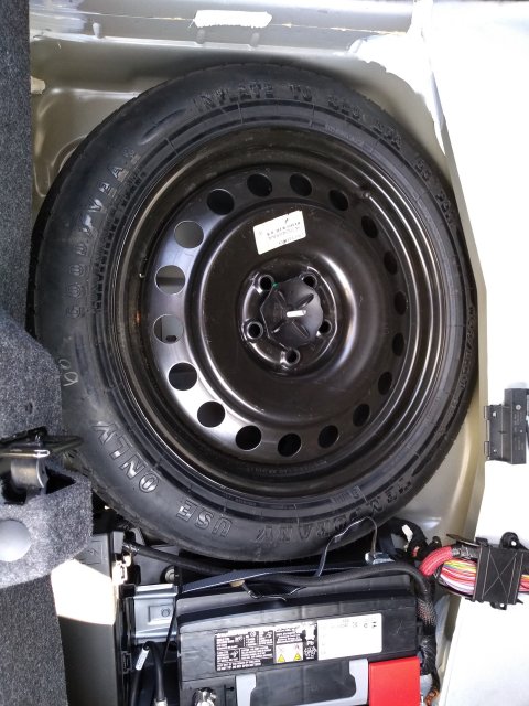

Can you still access your tire well under the trunk carpeting? I took out that big piece of styrofoam and was able to mount it all there. The jack and all mount under the tire. There is a wingnut under the tire that holds the jack and handle down so it doesn't rattle around. Then there is that big flower looking hold down on top of the wheel that holds the wheel down (this is the stuff mounted in my car. I have also included some size comparison pics compared to my factory tire.

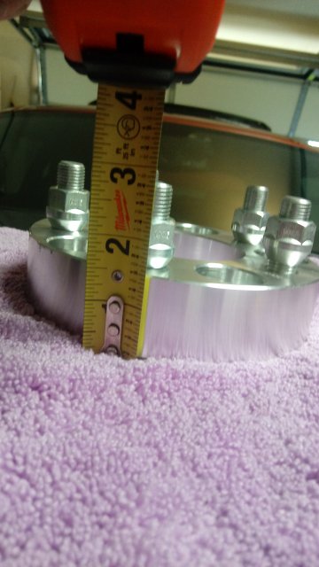

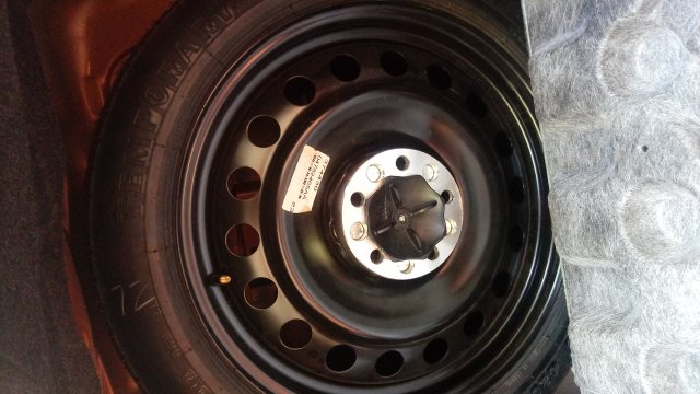

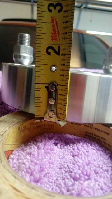

This is what he told me about the spacer, and these are the pics he sent me. He has a 2011 SRT 392, and his car came from the factory with a spare and spacer to fit over the front 4 piston Brembos.
Many thanks to Roostking....not sure if he's on this forum or not.
"3 inches to the tip of the lug, Spacer itself is 1 3/8 inches thick "
