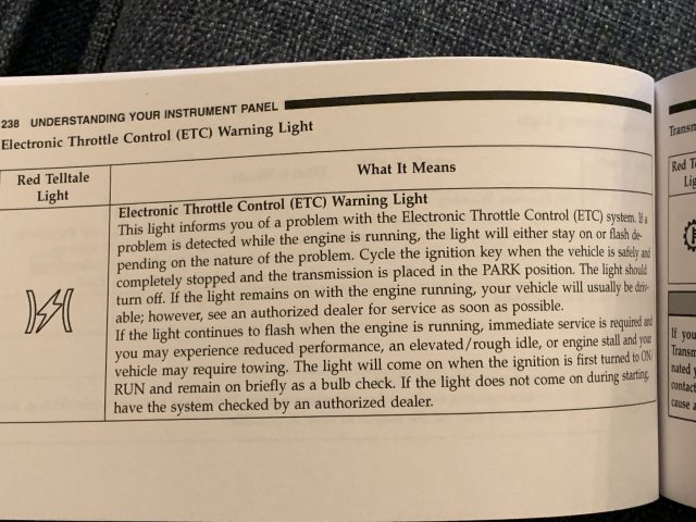

My redeye would do this anytime I'd make a tune change. One day I tried disconnected battery and touched cables together to do a hard reset after I uploaded tune and it fixed the issue. I don't know why but it worked. Throttle body relearn wouldn't do it. These cars are touchy.

On this whole red lightning bolt of Doom thing, I have to say I could never figure out what that symbol is supposed to be. at first I thought it was some kind of impeller or throttle body plate or something like that but I don't get the lightning squeezing through 2 opposed parentheses. To me that's more of a WTF light than a MIL light.

Maybe the bassackward parentheses are a model year thing.
17,666
55,246
My interpretation of it is it is the venturi region of the intake, and that there is an issue there.

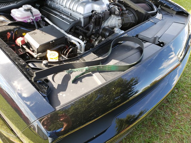

Yes, I got that symbol Saturday at Sebring on track. Fortunately I had planned for this and had the replacement I had with me installed in a jif. Ran fine on track today! My student with his e85 tuned 850RWHP Charger kept getting that and going into limp mode. 20211016_160436.jpg

It’s the throttle body warning light. Computer looks at feed back paths from it, one rising one falling at the same time, if it sees too much of a difference between the 2 it thinks there’s a issue or a disconnect from it. How fast is your ramp time set to in the tune?

Ill have to check, which table would I be looking at?

AIRFLOW- Electronic Throttle Body, then its in the center top, its usually set around .010 volts. Do a throttle relearn if you change anything in that screen.
