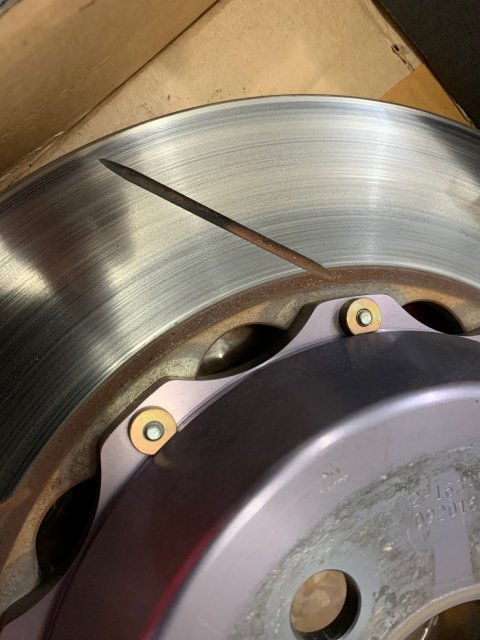

Pads are not the issue my friends, you guys have some rotors that are not right.
So IDK what you guys are looking at, but I see pictures of rotors I would immediately have replaced. Now, don't make me go pull off one of those Powerstop pads that look identical to these three. I just slipped the Powerstops in yesterday after changing my rotors back from my track set up to street. But here is what I have to back me up, those rotors are not right.
Three pads. Top to bottom...
Brembo Pad OE REWB 15 miles
Hawk DTC-70 half worn
Hawk DTC-70 three miles maybe, not even bedded
Now rotors. If anyone is imagining lines on my rotors consistent with those pictures, it is not.
Here is a closeup of the left rear again.
And its Sister on the right side..
Okay and now for the finale we have a GyroDisc aka Demon Performance rear rotor that matches the correct examples of expected OE rotors pictured above. I would be horrified to see those other rotors on a junker!
So @DodgeCares what are those rotors pictured by others that do not have the same contact area as what is normal/expected?
