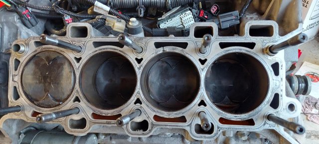

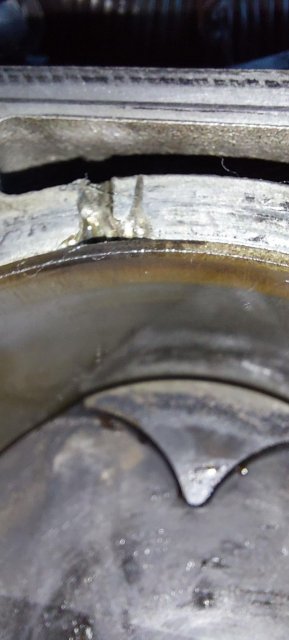

This is what blown head gaskets do to aluminum and steel. This was a 5.2 block with high grade sleeves. Used a MLS gasket with 8620 ARP hardware instead of a MLX gasket and 625 ARP hardware. ie cut corners at 28 psi of boost, The blown “fuse” ruined the block and the head.

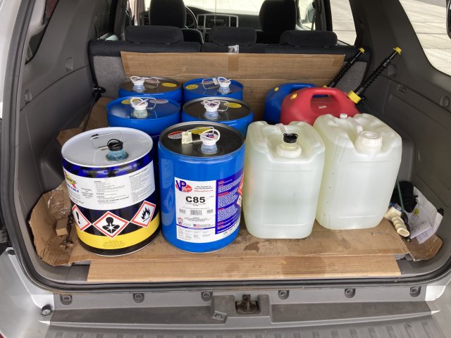

Here's a dumb question from someone who's not familiar with C85. Do you still need to test it?

My point is something caused that not just boost. I saw a story on a build they used cosmetic gaskets on and it went lean. This motor didn't blow a head gasket but took out a bunch of pistons and had to fix a cylinder

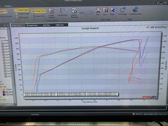

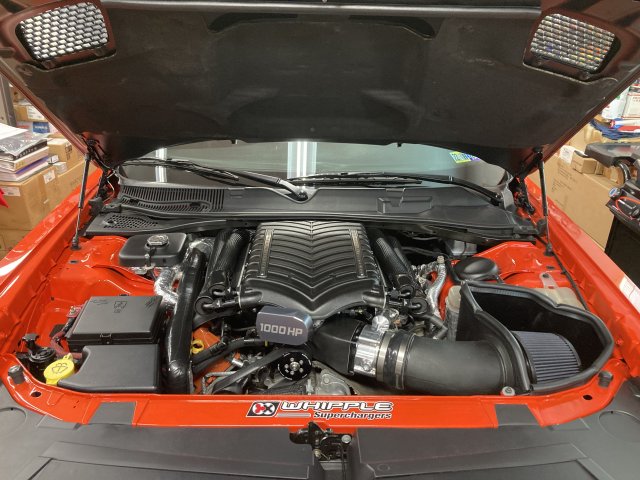

Here’s my results, first pull 19 degrees up top, second pull 20.5 up top and 1 degree added everywhere from 3200 up, 22-22.5 psi of boost. Spun on the dyno top of the second pull, numbers exceeded my expectations and I was out of injector (ID1300X2) and pump (twin 295’s) so there was no point in tweaking for any more. MUCH THANKS to @jonx96 for his help getting to these numbers. There’s more in it yet just need more injector next.
View attachment 82275 View attachment 82276
Rocketman!!!

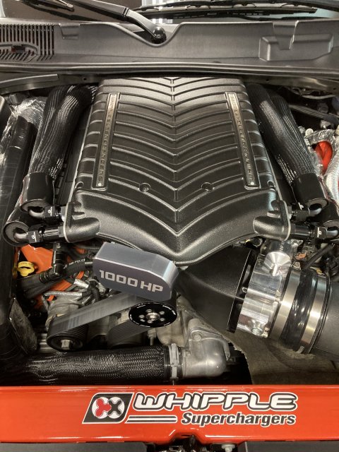

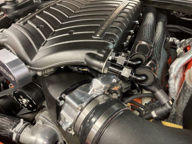

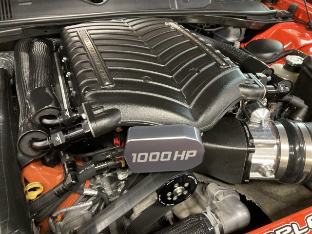

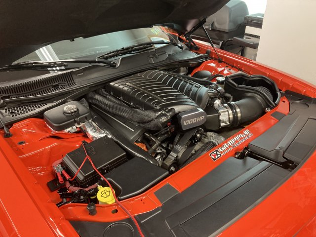

Can proudly display the 1000 HP badge now and those ugly hose ends gone replaced with AN fittings.
