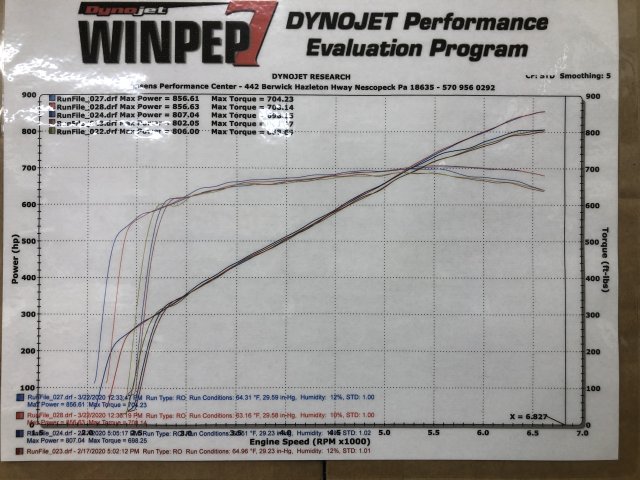

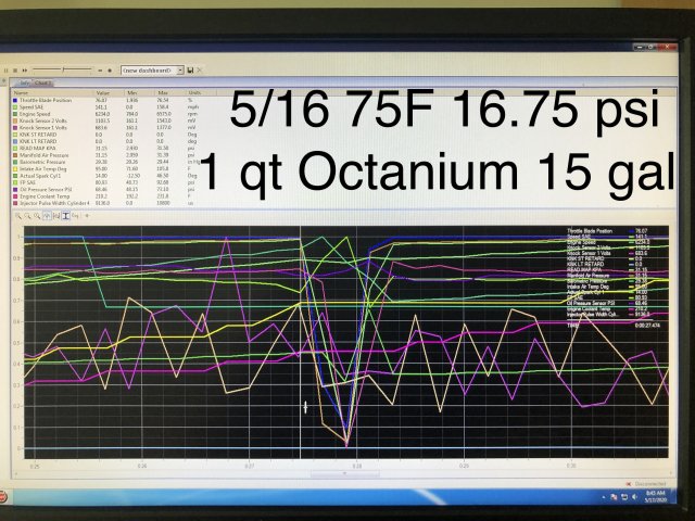

I swear by Octanium Unleaded, I used Torco in the past on other cars it leaves lots of orange soot, Boostane ehh, Octanium? The shit works period. Cut my Knick sensor volts in half and I’m running 16.5 to 17.5+ psi of boost in good air on Sunoco 93 and put down almost 860 wheel. Data don’t lie B24CC5F2-770E-4B7C-980B-209846A44096.jpeg D603471A-75B1-44D9-A654-D258EC1CD26A.jpeg 0CD05CBC-A4F5-46B9-84B6-8912139B9D50.jpeg

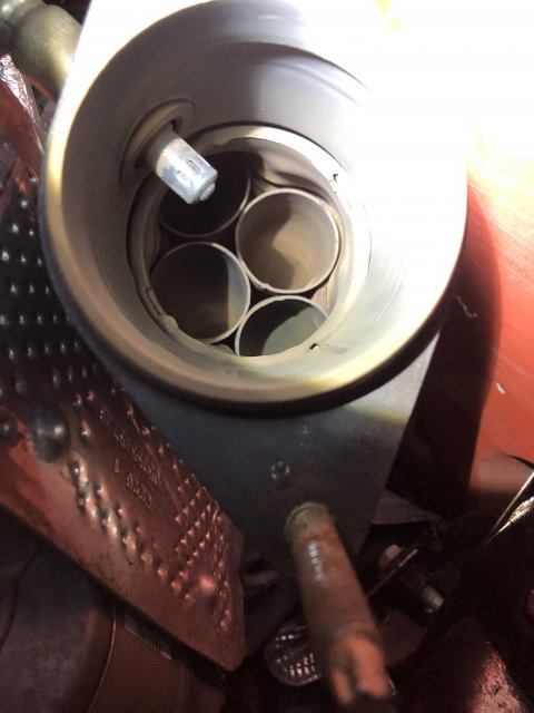

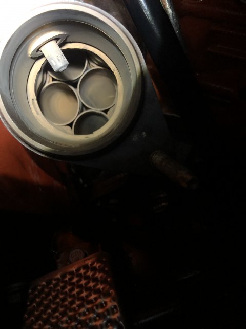

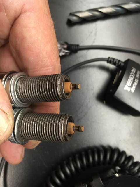

It does leave some orange residue but nothing like Torco leaves and half as much as a Boostane. I pulled my pipes after 10 or so tanks of it to see, plugs looked decent as well 8C7E3C66-BFC3-4C08-B321-1E02D6D41F1E.jpeg 62DA831A-F004-4755-A54C-30E909727382.jpeg 6C68654D-729D-4C48-B17A-3F60463020A2.jpeg

Does anyone have an answer to if that orange residue is harmful to anything like the plugs? MS109 is $90 a pail for me, which isn't terrible, but like others I'm not rich either, lol.
7,838
49,235
Blowing through a few tanks in one day at high RPMs does this. Goes away after, only happens on track days.
3,588
8,447
I’d rather that tinge of orange then black soot any day!!
Never seen it that far back though lol, you must have really been on it!!
