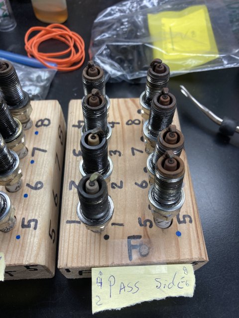

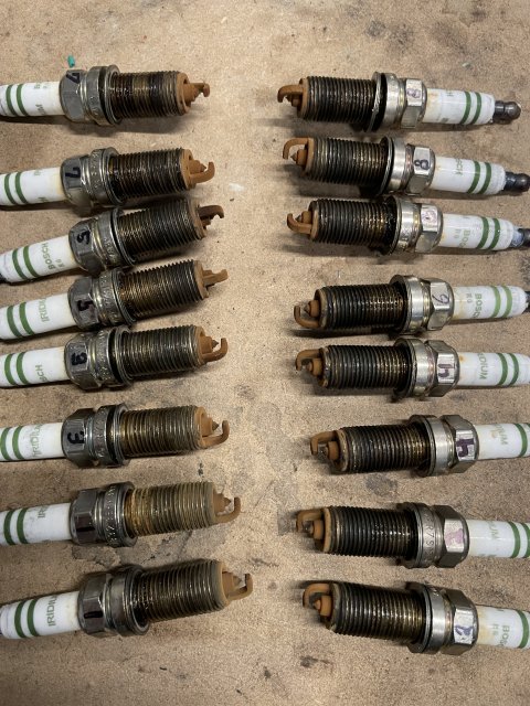

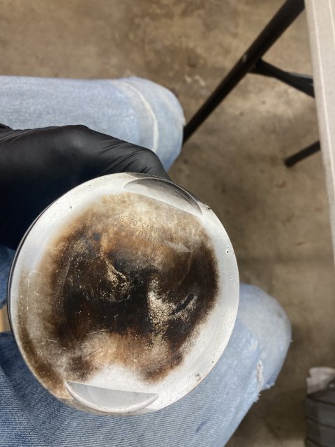

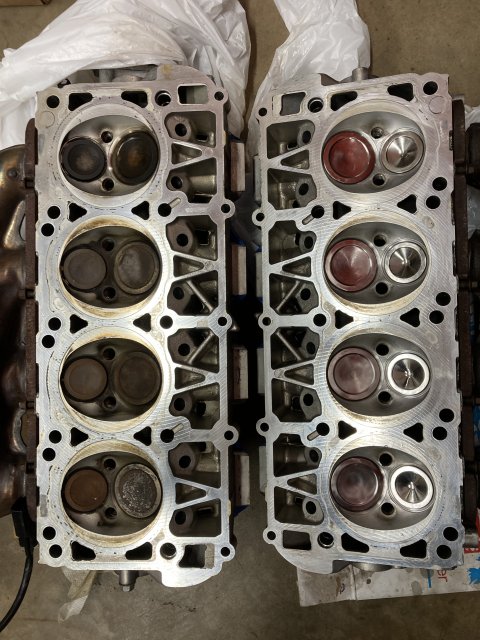

My advice, use it in emergencies only. I was a constant user and swore by VP Octanium Unleaded. It no doubt works, I have many dat logs to prove it, but it hammers spark plugs, exhaust valves, and O2 sensors, even though it says it’s safe on them. Here’s what my plugs and heads looked like after about 7000 miles of the stuff, 1 Qt in 15 gallons. Pistons clean, other important stuff not so clean, exhaust valves being the most concerning as plugs and O2 sensors are easy and cheap to replace, exhaust valves not so. Dirty head on left, cleaned up one on right.

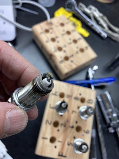

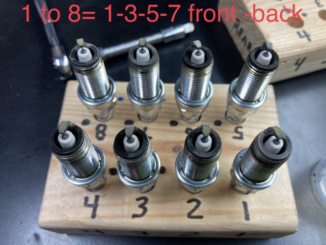

Switch to corn!! This is plugs after 3000 miles on corn!! Put them back in the box and sell them as new lol

@Mean Cat Had to thumbs down the post, will leave your spark plugs looking like Ronald McDonald’s Afro

I know, much controversy on Boostane & others, but your plugs have 60k ? on them & at what mixture was used ? a bottle to a tank full ? It's cheap insurance, I can't afford race gas & don't want E85. FTW
The tips of the electrodes looks good :LOL:
I need to pull a plug or 2 & see what they look like.

For those of you with orange parts… which one of those parts failed because it was orange or had deposits on it?

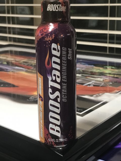

I’ll just drop this here, 4(+) years in my 2015 with no issues and a 93/95 octane tune. One bottle per tank of 91 octane fuel. Also have run it in my untuned 2019 Redeye from day one. Same result. Has been tested and proven by many Challenger, Hellcat, Redeye owners. 6D9EB407-DE9D-4738-A6CA-3FA09E49A87B.jpeg
