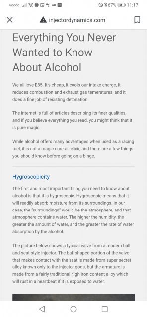

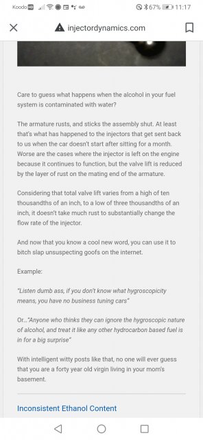

I am not a hater on ethanol. I get the use of ethanol and if I keep the car I will likely go with a flex fuel tune. Even though we don't have pump E85 here. At least it is a little cheaper than race gas.
There are lots of articles on the pros and cons of ethanol fuels.
Catdodgehell from the other forum had posted quite a bit of info there. I just did a quick look and this is interesting but from Injector Dynamics. Screenshot_20210527_111728_com.google.android.googlequicksearchbox.jpg Screenshot_20210527_111736_com.google.android.googlequicksearchbox.jpg

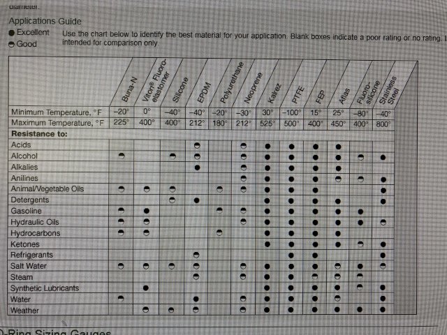

Silicon is so-so, Kalrez last forever, Buna doesn’t take the heat for long and gets hard and leaks

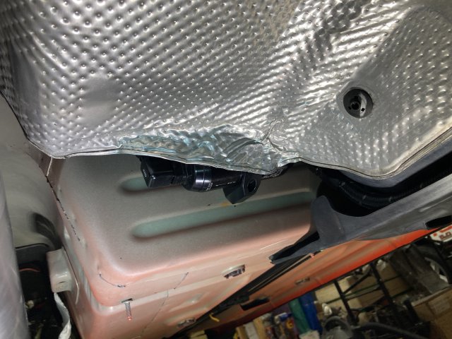

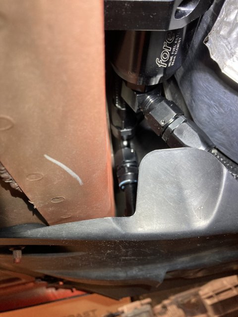

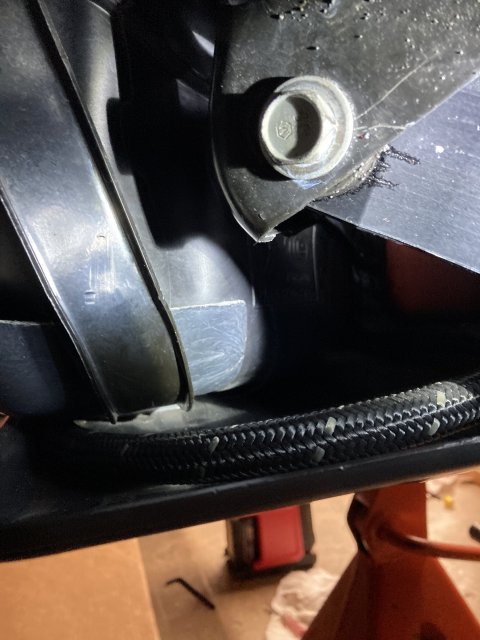

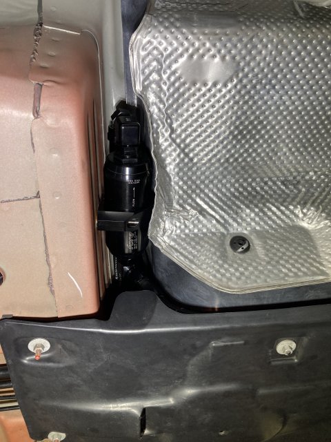

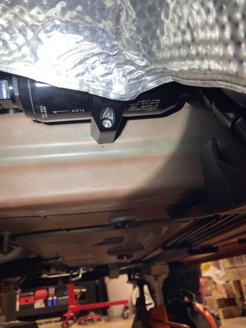

There are flexible lines but none are rubber, their that hard flexible black plastic stuff with quick couplings ends each end that couple to a stainless fuel line that runs from just under the fuel tank to about 12” from the fuel rail connector. I added the Tapped Performance E85 Fore Systems Microglass element 88mm filter unit which adds about 2ft of that special braided hose that fuel does not permeate through.

Nice clean install. How'd you get to the top self tapper on the mounting bracket for the filter?
3,587
8,442
I didn’t use the included self tapping rust makers LOL. I used 6mm SS blind rivets and put RTV on them before setting them then painted over them. I used a dremel with a right angle head and a end cutting burr to make the holes in the body. Then fastened the mount with 2 6mm SS hex head cap screws into the threaded blind rivets. I don’t like sloppy LOL. Here you can see one, there’s no seeing the other once the heat shield was put back on. image.jpg
