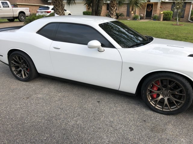

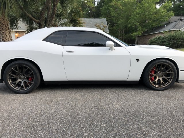

FR rims arrived today, not the best color match. They are more greenish then bronze, not as noticeable in a vertical position but side by side they are. I think I’ll wait on a set of 11” rims that are in the works arrive and mount the 315’s on them and put these rims in the attic for now. Tough to wait though but it’s said good things come to those that wait 🤞
View attachment 17691 View attachment 17692
That sucks your having such a headache color matching these rims. Mine are a little off too, but once on they’re really not that noticeable (on mine). I said F it and roll with it for now, but totally understand where your coming from. I’m sure we can all see the color difference from these pics but I don’t think the normal every day joe would notice

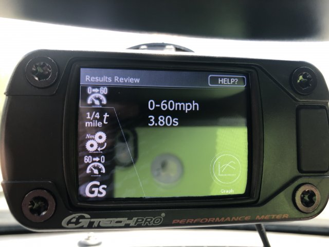

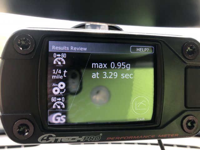

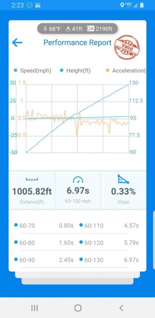

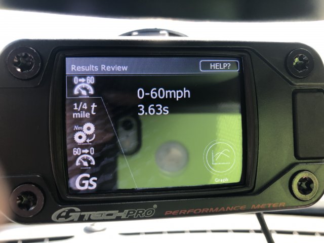

Ok, mounted and balanced, impressed totally with the balance, one took .75 oz and the other only .5 oz, nice having only 2 small squares of weights to look at, their black and can’t even see them. They fit same as a 315 NTO5R, I have about 2mm of clearance to the notorious front inner fender rib but no rub. Did 3 street 1/4 runs with the 315 555R2’s. First one wasn’t impressed, 28 psi cold turned into 30-31 spun in first and second, low 4 sec 0-60, but they only had 10 miles on them too, evidence of nubbie’s still in the centers and bigger as they went out to the edges. Second run aired down to 28 hot, spun and hopped a bit in first, caught better in second no hop, was back to 29-30 after the run. Aired down to 27 hot, first spun and started a bit of hop but second hooked hard and resulted in a 3.6 0-60 and .97G’s 1.58 seconds in, 60’ still 2.10, got to get first to put it to the ground better, was hoping for under 2 sec 60’. Cold tire pressure now after sitting 5-6 hours in the garage now 25 psi. Looking at the tire faces nubbies are all but gone in the center 6” and evidence of them get bigger as they go out to the edges and the outer 3/4” both inside and out untouched looking, look like they need to go lower yet even air wise and/or could use a wider rim. My first day impression after 3 runs? I think they may be better then the 05R, and I’ll be trying another set on the 11” rims sometime in June. I’ll be removing them and putting the NT05R’s back on to preserve tire geometry for a good alignment as now it’s on to installing the BMR Cradle and Diff lock out kit, installing the Speedlogix rear control arms, and getting a +.5 camber 0 toe rear alignment and see if I can get under 2 second 60 ft’s on the street which should then net consistent 3.2-3.4 0-60 street pulls. So far their a 👍
Here’s some data from runs 2 and 3

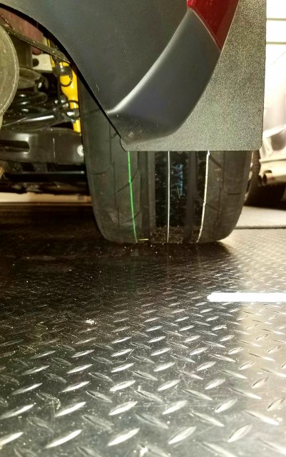

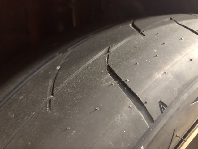

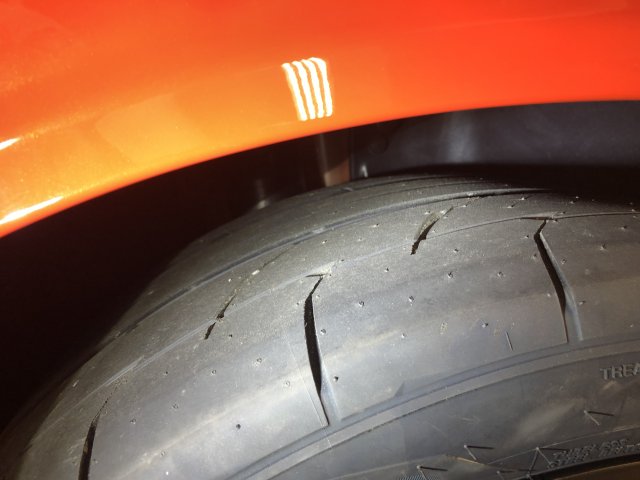

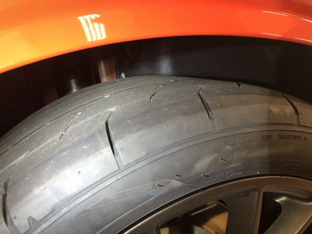

Here’s the tire faces, see nubbies all but gone in the center ribs but as you get closer to the edges the nubbies get bigger, this is at 28 lbs hot, and like this on the inside portion as well, pretty mirrored image that side, it seems to be planted evenly just not squatting on the whole tire. 25 psi cold at the moment, may drop another lb but worry about wheel hopping when there cold. I’m going to do suspension work before abusing them anymore so I can see what’s left of the nubbies do.
