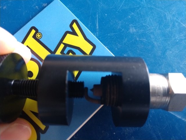

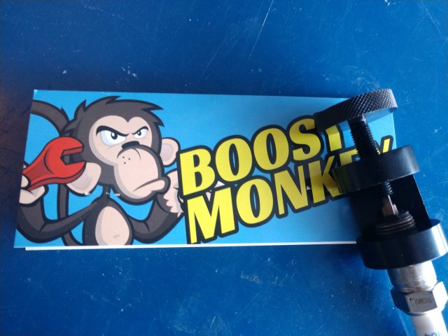

This Boost Monkey is great for tightening iridium plugs. Just go a half a turn at a time and test gap. I would not put the feeler gauge in the middle as you are tightening.

I am bummed. I did not get to use my monkey adjuster. NGK states these are pregapped at .031. They all came tight at .026 and it took a little effort to open them up to .028 with the side gapper. I will get them installed within a couple of weeks
