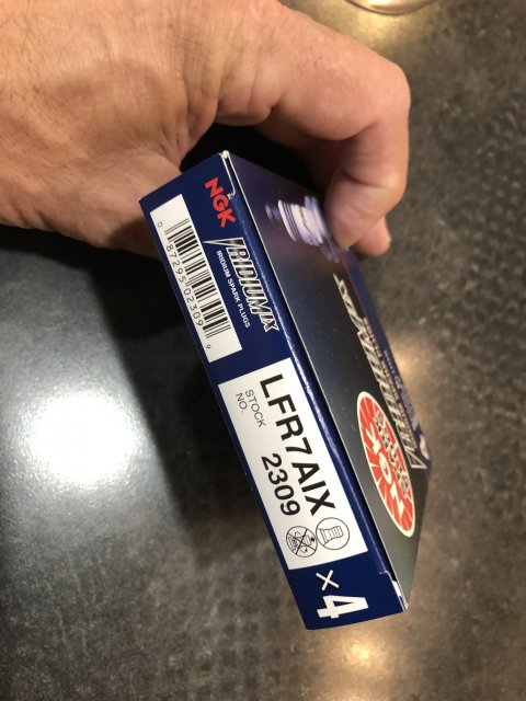

Ngk 2309 vs 7aix+11?

I think they are the same plug. One comes gapped at .031 and the other one is gapped at .045 or so.

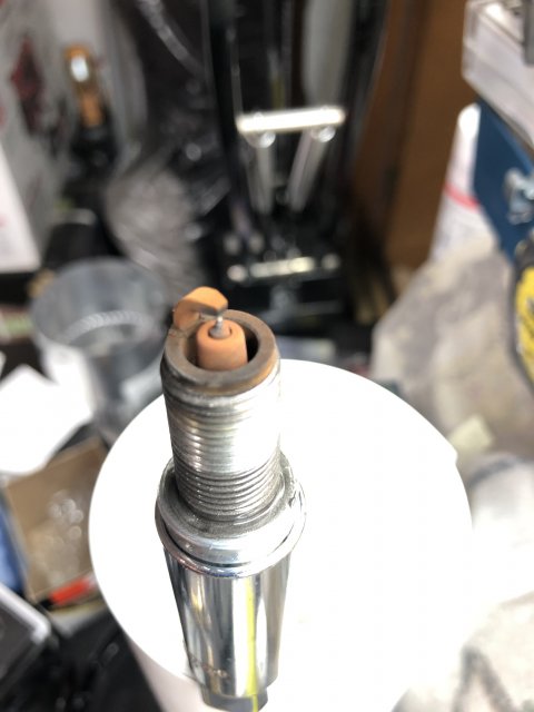

They run nice at 16 psi boost on pump 93 These were run with Torco, Boostane doesn’t make them as orange but burn as clean. ECA44438-C206-4C60-BCF4-FCC8A3116663.jpeg

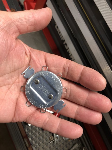

I use this Craftsman one, #40816

I bought a adjuster. Pretty cool. 14 mm. You screw in the plug. Then on the other end you slowly tighten a smidge at a time until the ground strap touches the feeler gauge. With me I am going to take the extra step by not compressing it with the feeler gauge in it.
