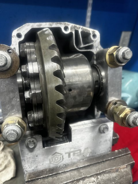

Wave track makes a carrier that’s what I put in
Ok, pretend I know zero about these rear diffs-which I don’t lol. What all is needed to put into one of these, and where do you source the parts from?

Hhp sells the carrier if you have a 3:09 diff now you can transfer the ring and pinon. And tba sells the cases seals and shims as a kit or you can buy a full rear end done from them

TBA also has the wave trac in stock. TBA also has the seals shims vise holder and carrier bearing holders Easier for setting it up!

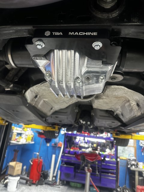

new diff is I. Sexy looking. Thanks Todd

This thing is purdy looking, kinda Jelly but I got some goodies on the way so I can't complain :)
0DFACDA9-BABA-4A56-BC4A-4ECB4C7F443D.jpeg 2FE9CF0A-18FC-4A22-993A-D5E92BFADE68.jpeg Yes you do

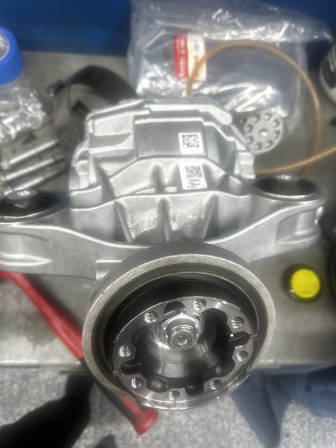

The caps are part of the back half of the case. TBM machine makes bearing caps you can put on to set up rear end. That is the only way with the with out the case 100% together
