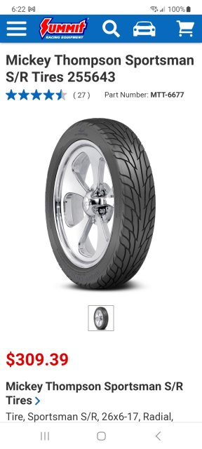

I used the Mickey Thompson sportsmen because of the tread pattern and they are used on many fast cars. They are heavy if that's a problem for you. Wheels were VMS 18x5.
Here it is in 17".

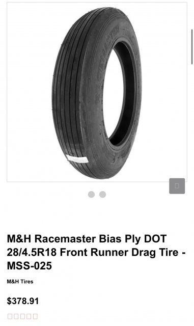

Apparently, m&h has a front skinny that “a lot” of people are running, but they don’t provide a load rating if to anyone. I run the ET Street Fronts, which are super light, 32 lbs with wheel. But I’m over the weight limit on them

My Charger didn't like turning on those Mickey Thompson sportsmen. I had to lower the air pressure so they would at least try...🤣🤣
Here it is in 17".
And $390 for the 18” (28x6). Insane the price jumps so much

That was the main reason I didn’t get them, besides the weight. Too much money. If you take a good amount of weight out of your challenger you can be within the weight limits of the et street fronts

I got them incase I was on the street, it started raining and they would hold up to highway use.
I won't mix radial and bias tires.

The ET street fronts are radial (I didn’t post a pic). I really know nothing about the m&h tires, but people run them (probably just at the track). I drove with et street r and et street fronts to the track. No worries. But got caught in rain twice. Bad time
