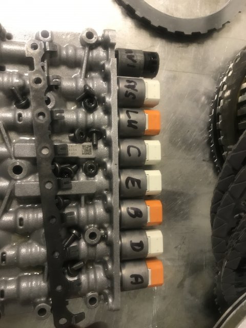

I logged in street mode only Cole , I was saying had I logged in sport or track mode I probably would not had this issue, before I went to ethanol and changed the rear diff I never had an issue but with the hard pulls in the interstate with the 2.65 pulley in street mode that’s the only explanation I have. , that being said I could be wrong it may possibly have a solenoid as the underlying issue , either way the E and D clutches are burnt and I have to fix it

On my last two runs the torque management showed up in the logs after the 1-2 upshift also the 2-3 shift would shift at 7000 instead of 6500 but I do agree that solenoids could be a concern because all the zf units I rebuild get a new solenoid kit but with mine having such low mileage I wouldn’t think they’d be suspect but then again I’ve seen new parts bad time and time again , I was already planning on sourcing new ones

Here’s a pic of the solenoid set up and identity of each solenoid there is a green solenoid on the valve body that is for park function only, I’m shipping the solenoids out today to my friend Noah at Ericsson industries to have the solenoids flow tested , this will be critical as I have found out the solenoids are NOT available separately, you would have to buy the Valvebody from Chrysler at a cost of around 2,000 I will know next week how they tested and of course I have my fingers crossed that they pass with flying colors 7B975174-E70B-4312-AE11-8C0E3DBC4649.jpeg
