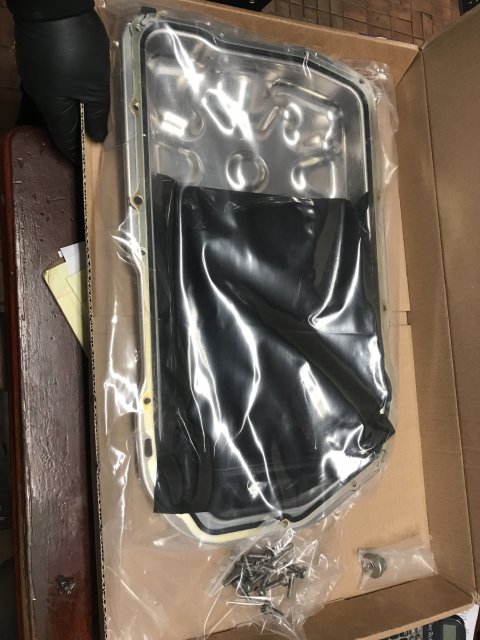

Unbelievable but this was the only way I could get the filter come pan and filter and bolts what a waste of money on Chrysler’s part in my opinion but it is what it is 237336DA-DE62-4A70-92D4-F6F64030EA59.jpeg 0587A703-18DF-4C5C-8D79-3376A4427AC9.jpeg

Looks like there pretty proud of that kit!

Yes they are but so not necessarily the pan as you can see is metal and the gasket is one that can be reused the bolts are not reusable but could be replaced with steel ones easily I’m sure later the filter will become available

My buddy was telling me about that last night! I guess that's part of the "lifetime" fluid in the trans. His co-worker took his RAM 1500 in for a trans service and the dealership told him it's not serviceable and that the pan and filter were a set.

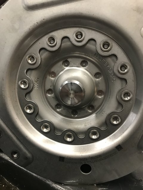

Can anyone here tell me if they know how to identify the demon converter from a hellcat converter???pic attached of front converter I want to make sure I wasn’t shafted lol D3B61DC8-9373-41F9-91C0-84C7E7CF0BB9.jpeg

The part number should be somewhere on it

But which is it?

RL378429AB
Demon converter

There’s no number like that on either mine or the new one
What numbers do you have ?
Look at the pic

Can anyone here tell me if they know how to identify the demon converter from a hellcat converter???pic attached of front converter I want to make sure I wasn’t shafted lol View attachment 7762
Probably just by the part number, I would imagine most of the differences are internal (stator (K ratio)). 151k (1.99:1) torque converter than the standard Hellcat’s 137k (1.70:1) P/N RL378429AB

Guess I’ll find out when o install it

Hmmmm that's it for numbers stamped on it?
Yes I’ll call my converter guy and see if they have any info

Can you ask to see the part number from your converter guy off of the original order form?
