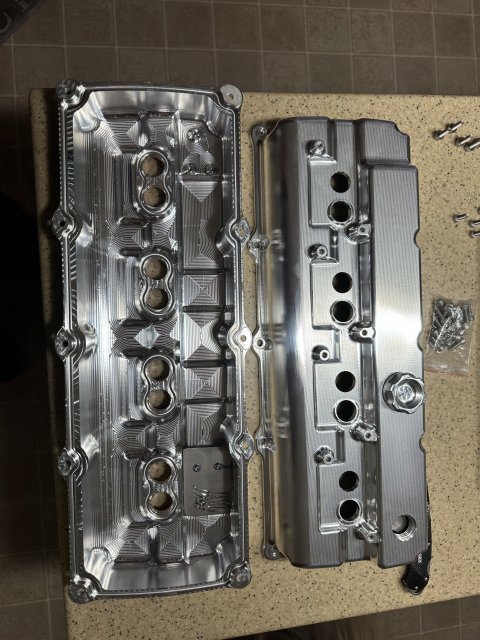

These look like they are going to solve my oil leak issues! Very nice design! much easier to install as well. Manton Valve covers FTW

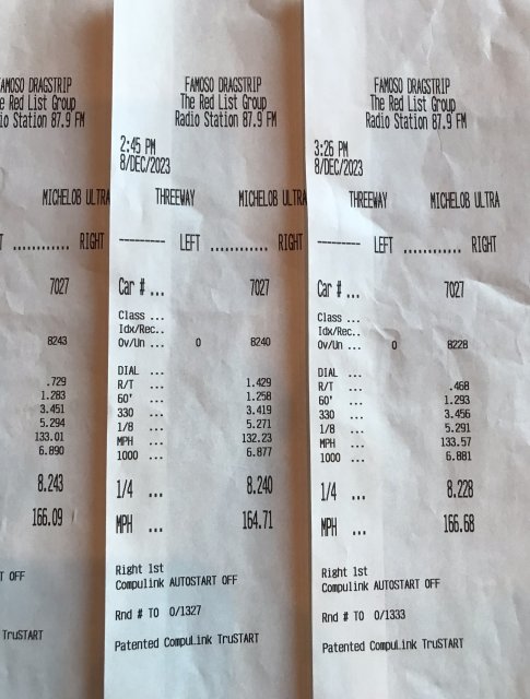

I’ve got a 8.20 bracket car now. So I think I’ll change everything 😜 C771DAB7-5D2A-44CA-B870-6C7194FB9134.jpeg

Man!! Those are nice. Is there any reason those can’t be installed with the baffled side down?

I’ve got a 8.20 bracket car now. So I think I’ll change everything 😜 View attachment 124389
haha right!! Man I think once this round of upgrades is done I'm sticking with it this way and just going to enjoy the race season. should be where you're at on the bigger pulley so I'm not stressing the engine. I know it picked up 4 tenths on the Dragy from 100-150. haven't been able to get it on the track since though. getting close to solving the small issues so ill be ready when a track opens.
Not sure I would have to differ that question to someone whos tried. I don't see why not. as long as you have the room to clear.

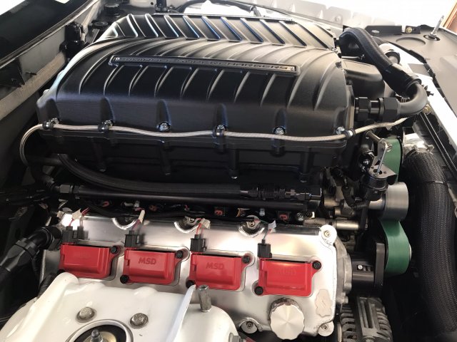

First step in doing that is tuning them over so you can run your coils up and puts the breather hoses at the rear. Those new valve covers are too pretty to cover up with a bunch of wires and hoses. 83CC9A15-43BE-4B87-A134-F2FD9D1514EA.jpeg

also looks like you have the holley ecu and not stock wiring anymore. the stock stuff is a cluttered mess.
3,612
11,637
The one picture is when we had the Holley Smart Coils that caused all the problems. Gave up on those and changed to the MSD’s. Those are simply stock coil copies that are rated at higher voltage. They work good with no issues. Plus they’re red! 😎

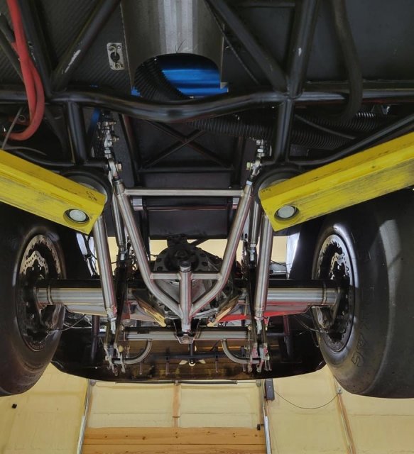

We have those on the other two shop race cars. I have the less expensive Strange Engineering coilovers on the front and drag shocks with Hyperco springs at the rear. I haven’t been convinced that the Mencers are going to do anything more for me than what I have now offers. The ones I have are 20 point adjustable (10 up and 10 down). I’m getting ready to modify my rear by changing to a wishbone center setup instead of the panhard bar. My goal is to convert the car to a small tire class to go with the turbos. Going to end up looking something like this…. 396BDD46-AB1F-400D-99FF-594E790796FC.jpeg

I'm still on the stock IRS rear suspension setup. I believe others have seen some pretty big improvements with the Mencers and QA1 mod coil overs. there is really nothing modified on my car just stock replacement parts.
