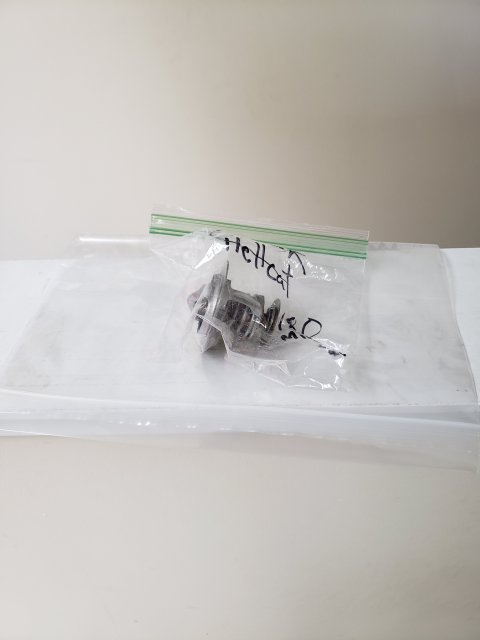

The one that opened and closed most consistently around 180, purchased from 3 different stores as 3 different brand boxes but all motorads inside each View attachment 70656 View attachment 70657 View attachment 70658 box, all around 10$ each. I always test T stats before use, I bring them up to temp very slow and watch which one cracks first, get fully open first, and closes correctly then make a pick and return the others for refund lol.
Ah yes, the good ol' Motorad 4128! I have been using them since 2007, bet I've done at least 20 thermostat swaps. So I've never had a problem with them, but I feel like I read about a lot of failures on them over the past 2 years, saw some mentions of the Mishimoto so I thought I would give it a try. I think it was almost $50 too.
So the Motorad/Jet/whatever seems to hit 187-188, then settles to 185 after airflow and open loop mixing...the Mishimoto seems to open at around 177-178, mix for a bit, then adjust up to 185. I only threw a code one time over the years with the Motorad/Jet, did right away with the Mishimoto. Will probably swap back. I drive to work early in the morning and my car just gets up to operating temp by the time I get to work so I think I really test the code threshold.

Small update here, swapped back to the Jet 180/Motorad 4128 unit and my code P0128 has gone away after a few days.
This one climbs to 188-190, then opens and settles at 185 or so(when air is moving through the car of course).
