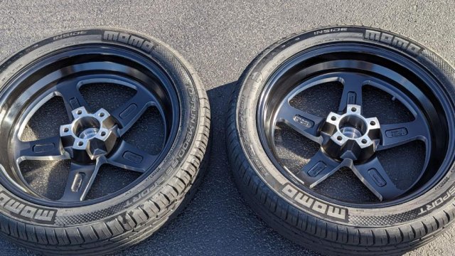

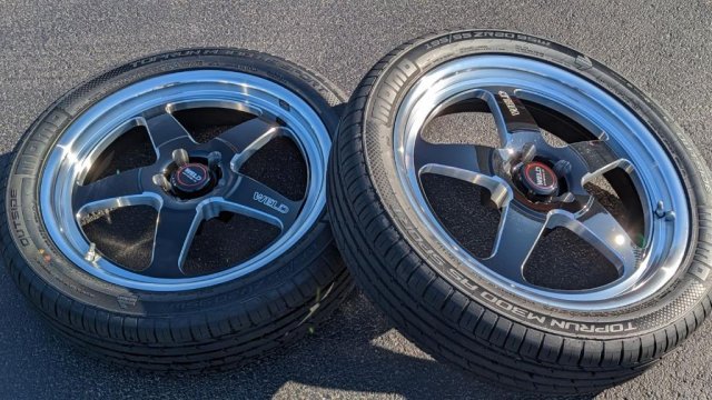

They make skinnies for your years. I have a pair on deck if you are interested with tires.
if you go up in boost 93 will reach its limits quick, might have to splash 104 in to make sure you don’t detonate.
i won the 10.0 class on a 2.72, but it required 104 to keep the motor happy
49,497
159,499
to my knowledge there are no skinnies out for the 2018 up (whatever year they went to slightly bigger brembos). i would want to try to stick with 93 just for simplicity sake because i drive my car. if we get e85 local to me i wanna go E though. i wasnt sure if a 2.85 would get me to 10.00.
2.65 pulley and e85 I was right at 10.0 in 3000 da at 4650 lbs
49,497
159,499
I thought they didn't make skinnies for the '21 up cars with the bigger brakes?
3,534
8,610
