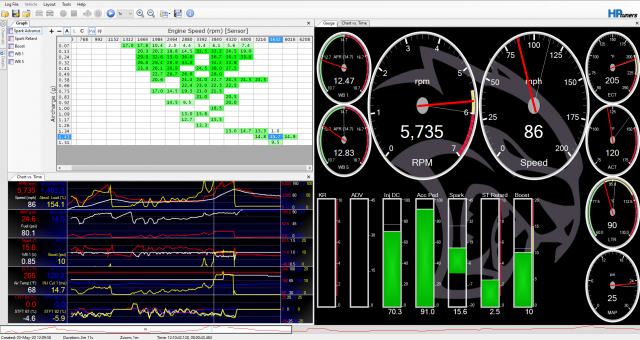

I think in my last tunig vid I show all the pics I log. I've found pid names change from cal to cal.
3,533
8,608
I must have missed it, I am subbed and never got an alert, for all those looking:
3,533
8,608
After watching the video and looking at the calibration file, I really have my UI setup so I can get to the data that I want. It's quit interesting on what I used to log with my Scat Pack vs what is important for Supercharged vehicle. Also spent some time playing with the gauges, charts and graphs to customize them to my liking. Even found a bug and submitted it to HP Tuners for fixing. Thank you for the video. Now to get all the juicy data and write a tune (maybe, one day...)

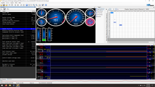

I am new to this and also copied Speeds Channel List...Thanks Speedy. I also picked up some PIDs from B. Mason's youtube channel. He had a couple of PIDs that you can only get if you build your list while connected to the car and it may have to be running??? (e.g. active exhaust). After you add them to your list, they show up as phantom until you connect and start recording. You probably already found that Boost is in the Math drop down and can be added to the Chart if you have the PIDs used for the math in your Channel List.

Can to further explain selecting the re-poll for parameters (how to do it and what it does...is that just recording a new log file?). Thanks
