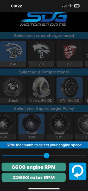

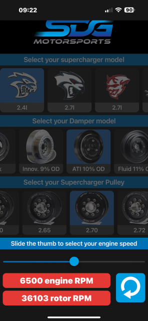

So make it make sense. Last time the car was on the dyno it had 2.70 upper and 10% lower. With this, the car always felt loose, ready to just be a rocketship.
Last night the car was on the dyno as we were trying to slow it down. Went with a 3.0 upper and 10% lower.
Car felt like a freight train but solid, didn’t feel loose but felt deadly.
Now if we use SDG’s tool it does not like the 2.7/10% combo. However it does like the 3.0/10% combo.
Its as if removing the heat from the blower negates the psi from having it.

Wow, I had no idea that tool existed. So the less is more theory here
8,508
7,433
Wow, this tool is amazing. Now I know how much I can pulley down

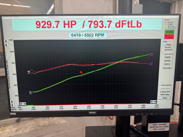

900 HP Hellcat Dyno pull.
