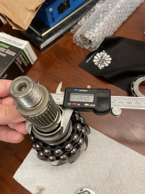

to see if they have a solution for Hellcats or something that may work. Right now eating dinner so I will take my measurement tools to it in a bit to get dimensions. Also a very good option to the crush sleeve, you can torque to hell and it's not going to become useless.

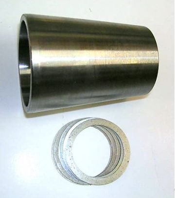

The pinion crush sleeve was the weak point of the 8 3/4 back in the day. I remember someone made a kit with a solid bushing and shims. maybe something like this can be made.I can check bearing preload as I have a 3.09 and a 2.62 spare. It will be late tomorrow though.

I think I used the one from mancini racing back then Looks like this

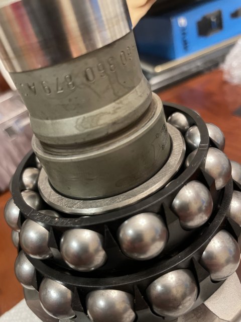

So I am once again in believe that dodge/zf engineered these to be non replaceable. the shaft has a taper and then at the bottom of the taper an 1/8th of an inch is machined out so you cannot place shims at the bottom and is required for a kit like that.
if you were to make a crush sleve eliminator then it would have to be machined in such a way that the bottom would fit at the taper and then the top hole machined to the rest of the shaft

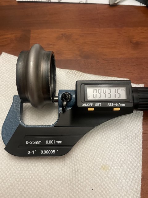

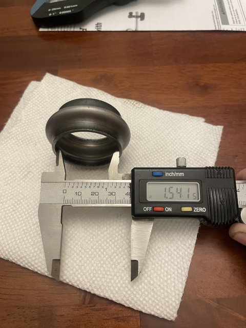

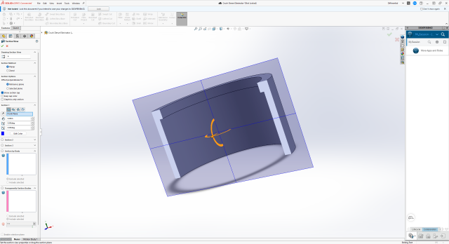

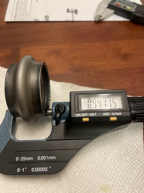

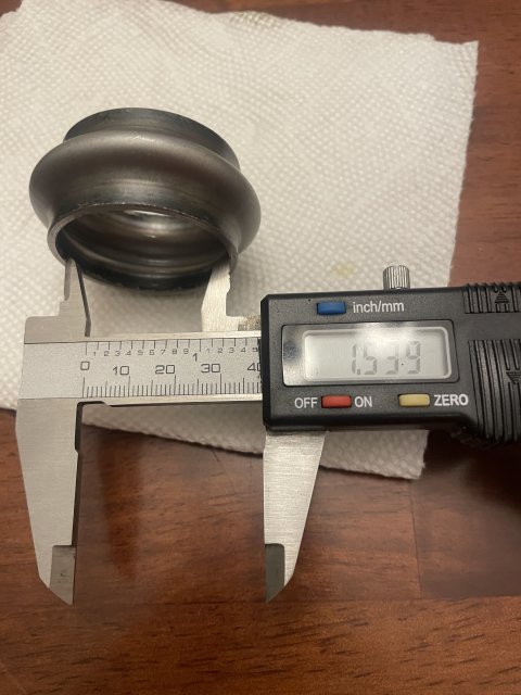

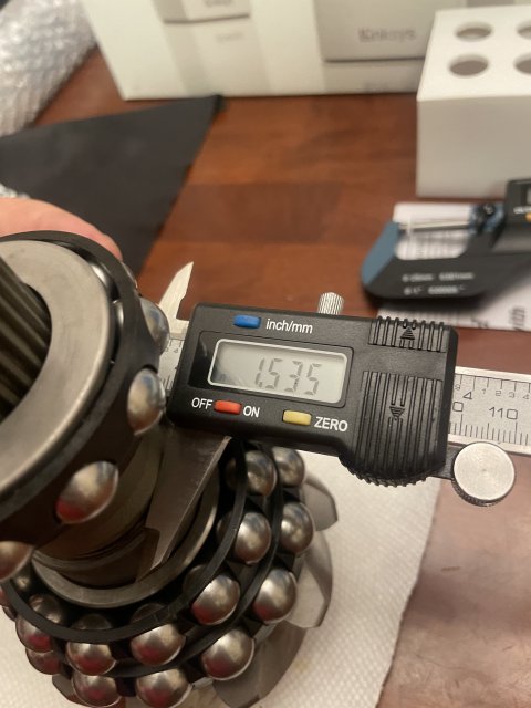

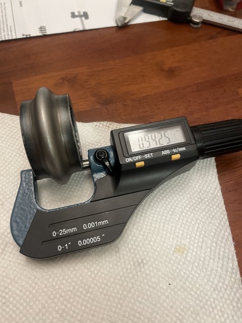

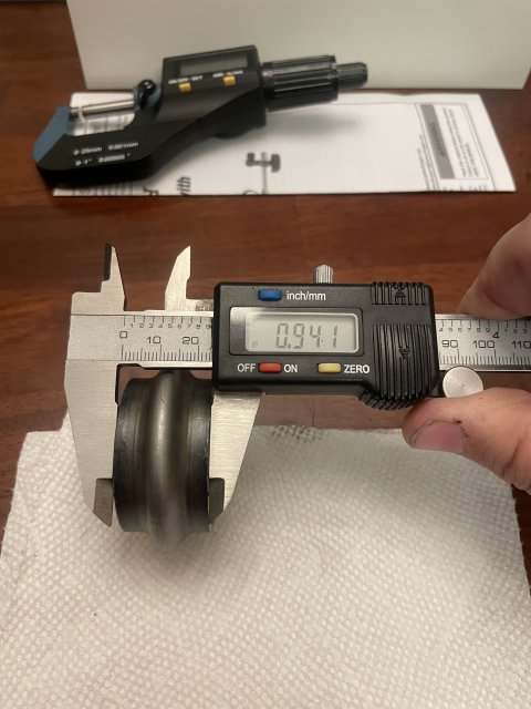

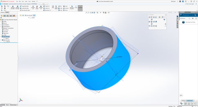

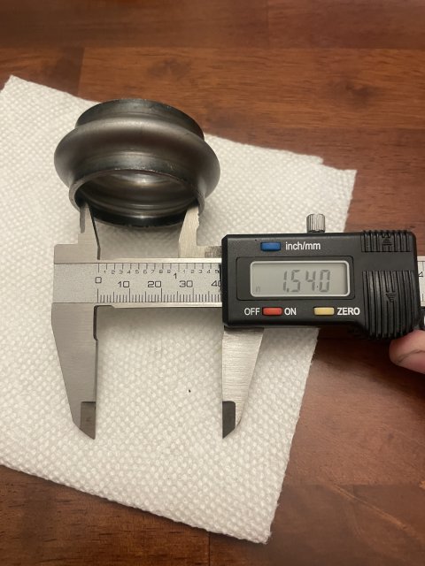

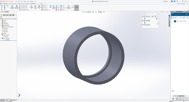

@Unholy707 and I have been talking about CAD work and I'm like I'm such a goonie right now. Fired up solidworks:
Top of shim has 1.440 ID
Bottom of shim has 1.54ID. Whole body has 1.71OD.
Shelf for shims to rest against is 1/8" thick. Tolerances were left a little loos by .001 for fluid
I went with a overall height of .942" as that seems to be the middle of the road. Shims would be custom sourced to match the shelf ID/OD (37mm id, 44mm). Just in case shims would be in a five pack: 5 * .001 = 0.005 of play. I thought about ten thou: .0001 for play but that is ridiculous. This is not really that precise in nature and a guesstimate at best. Thoughts? Going to contact the local makerspace tomorrow to see if someone can rough it out if I got pick up some stock at the metal supply place.
4,109
10,308

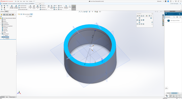

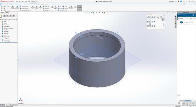

Thread Starter #1,833
Visualizing the shelf. Good fight, good night. Also asked on the MSHS group on FB if anyone else has done this before I re-invent the wheel...
