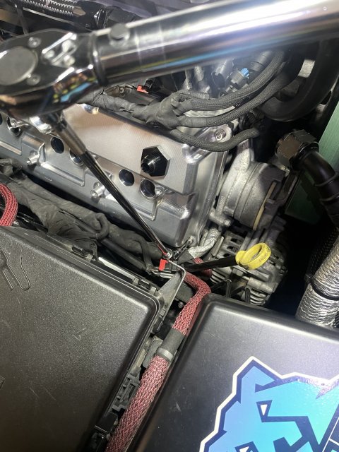

Feel defeated, these covers are just as shitty to put on as the other ones were to take off. In the video above the guy uses some 1/4" drive voodoo that I don't have. Will be bright and early at home depot to get robbed of some money for 1/4" drive extension and i don't have 1/4" hex sockets However there is already plenty of room already!
sometimes you gotta get creative… View attachment 97723 View attachment 97724
@16GoManGoHC2 not only pulled over the covers but pulled the heads off not long ago. Sure he has tips on doing this
3,823
9,057
Just plain old Craftsman 1/4” drive extensions and a universal joint on a flex head ratchet. Putting the heads back on in the car was a real PITA, mostly because I chose to bolt the exhaust manifolds on after getting the heads on and torqued. Drivers side not bad but the passenger side was a pain. Took me 3 days to get it back together. So far no signs of head lift, I’m back to 17 degrees of timing with 21-22 psi from the 2.4, will be going back to the Whipple soon, 5.90 60-130 just not w quick enough for me, 5.25-5.40 felt better, hoping for 4.99 with the ported heads, At least once!!

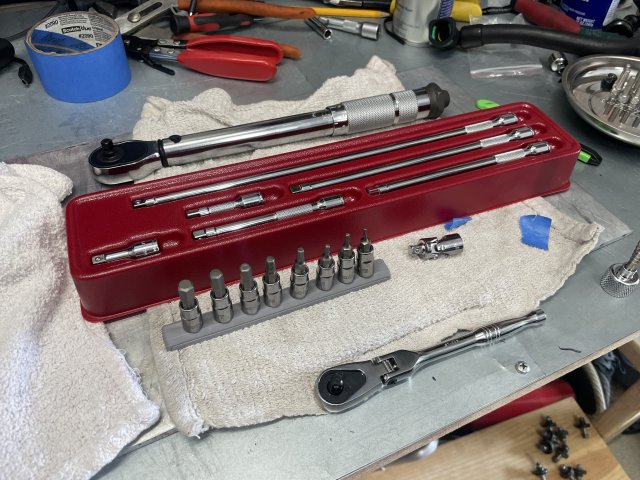

Added some 1/4” drive tools to the family.
Sooooooo much room, took 10 minutes

Home depot for the 1/4" hex drivers. Husky brand. For the extensions, Harbor Freight, ICON brand. 1/4" Drive torque wrench is Pittsburg. The flex head ratchet is OEM tools.

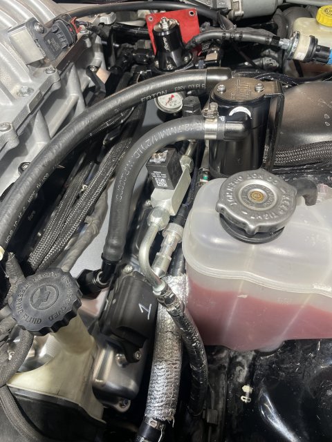

Just got done with drivers side. Making my new AN lines for the catch can. Easy day. This is what I was referencing @vortecd for space. Also use a mirror and inspect your gasket before and after torque sequence. Final result at 97in. Lb.
4,143
10,433
Thread Starter #1,173
Semi buttoned up. New an lines on driver side. Spent 48 hours thrashing, wouldn't have it any other way. Time for bed, gonna do the coolant side during the week.
