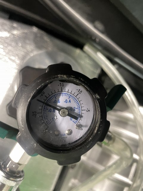

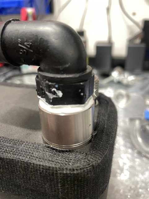

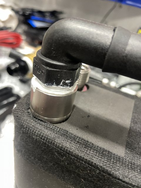

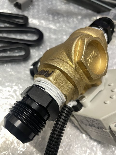

Leak down test, final assembly on the s/c side done. Teflon tape no more!
Pulled a vacuum, now to relax for a half hour.
4,113
10,325
Thread Starter #1,062

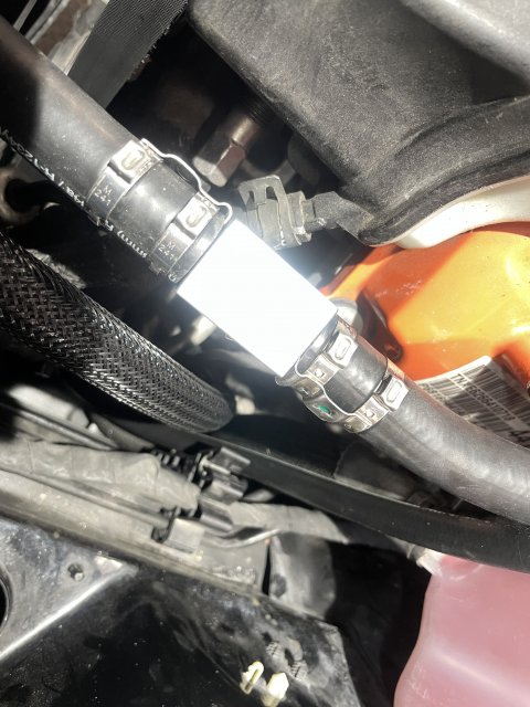

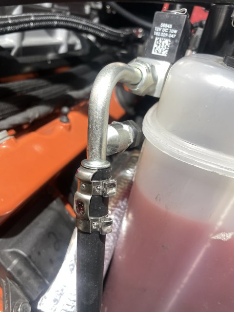

All done! Filling supercharger coolant tonight the a date with Starks Performance to switch to 134a.

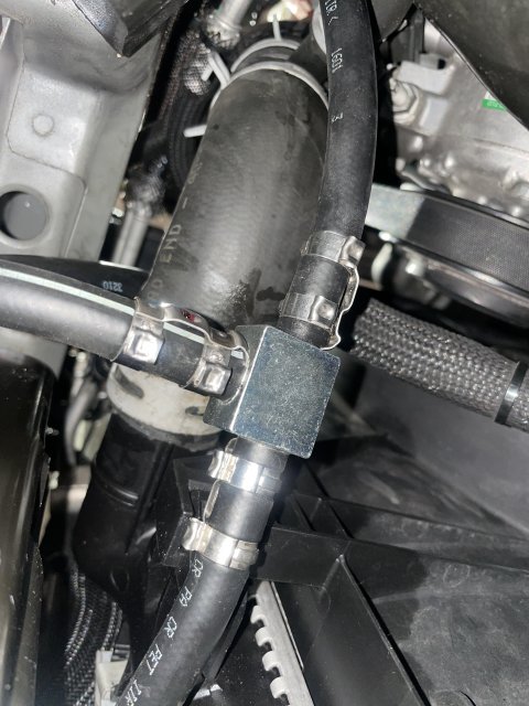

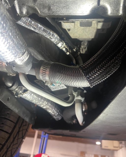

Lets talk AC lines first…

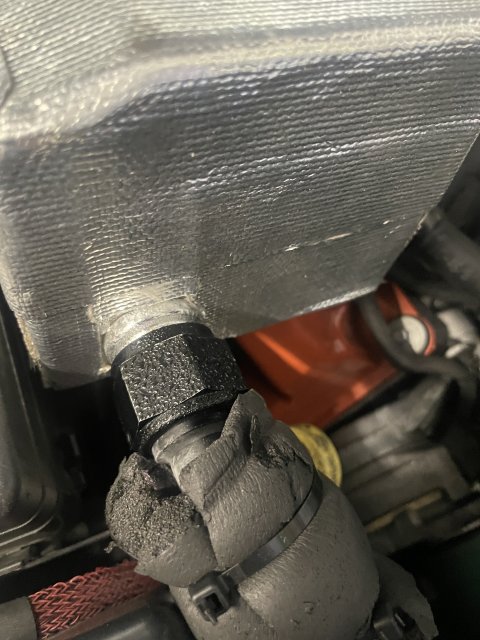

Liquid line from condenser

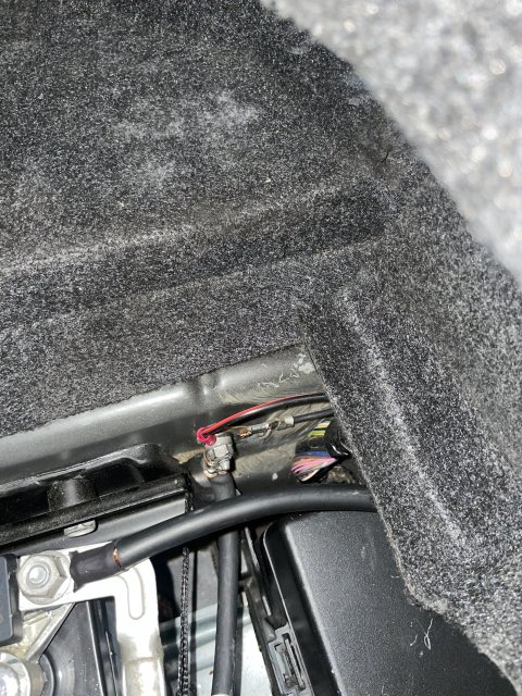

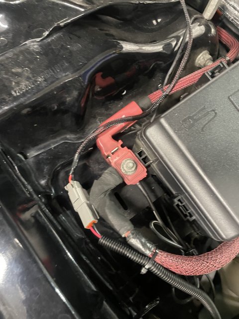

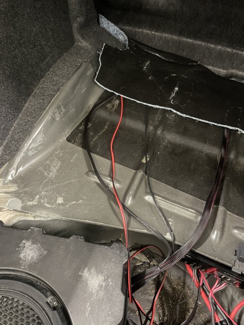

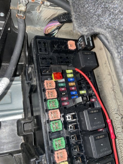

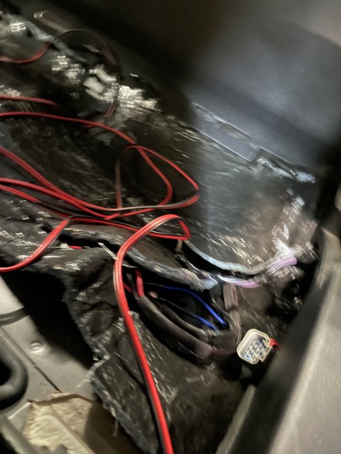

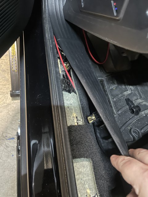

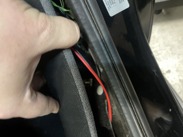

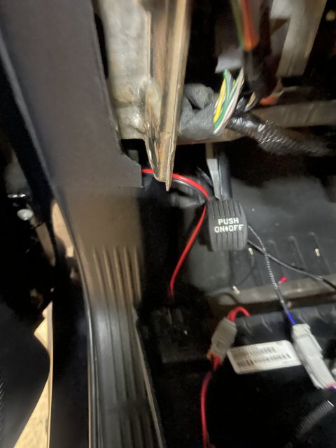

snake the main power from rocker panel to rear
snake through back divider to the PDC
112DB138-97D4-4C8F-88FC-6CF5F3C45BD7.jpeg 4F2B44C4-43EA-4A79-B607-26689CBD7449.jpeg B4BAE990-DF8B-420F-A628-AA1EE95EB74F.jpeg
i choose body ground instead of battery ground

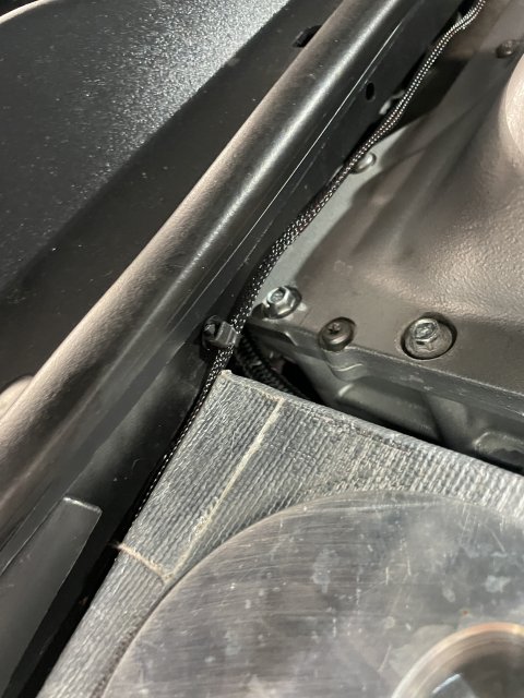

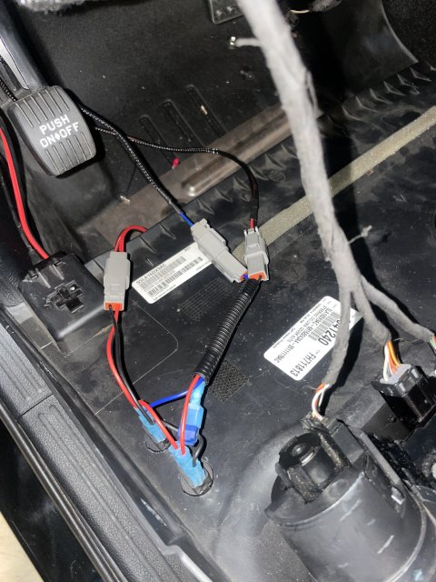

Now all the electrical
5DBADCE3-3E4C-4132-B5EF-895BE7AD4DE1.jpeg E6D58917-7364-493D-A7B7-0AAB0CF20CD8.jpeg 75B79E52-437C-4ECC-9395-1CAAF97C24F7.jpeg 48898922-F5BE-43B6-8A25-180E2A1CAAC1.jpeg 9B590A4E-6B99-4096-BBE1-D2CF4EFCC605.jpeg 210A7299-4CF6-497A-9AF5-33043844DCA7.jpeg

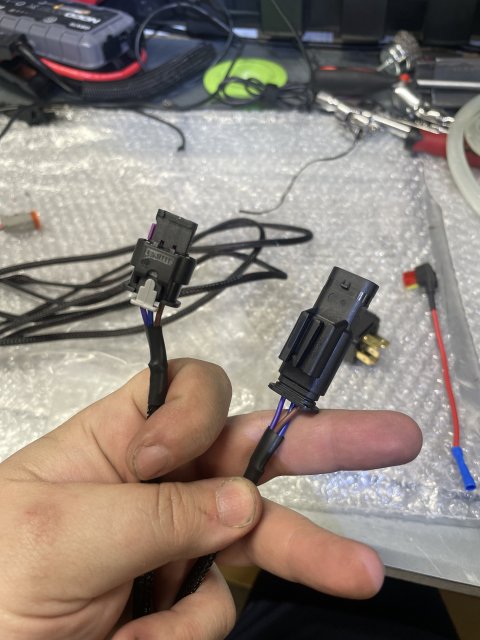

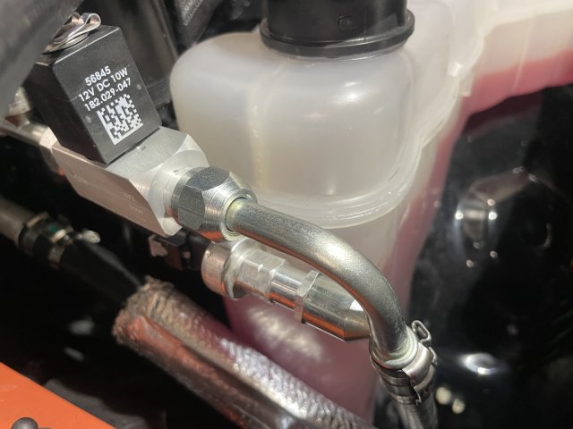

power for the three way bypass was routed along the strut tower then snaked through firewall to the switches.

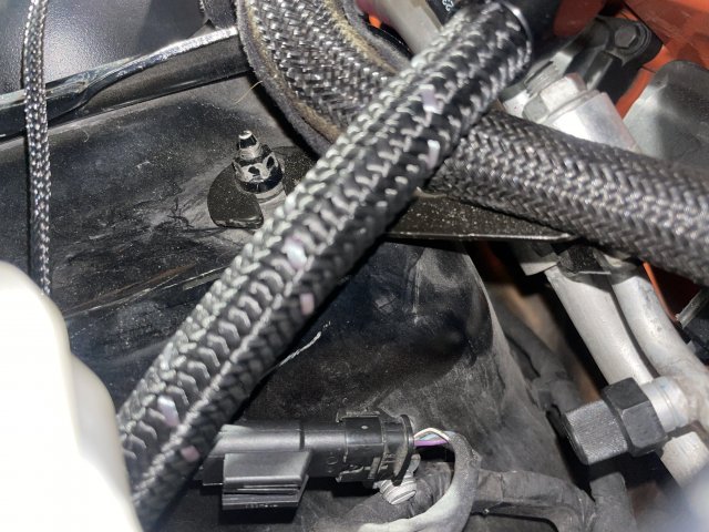

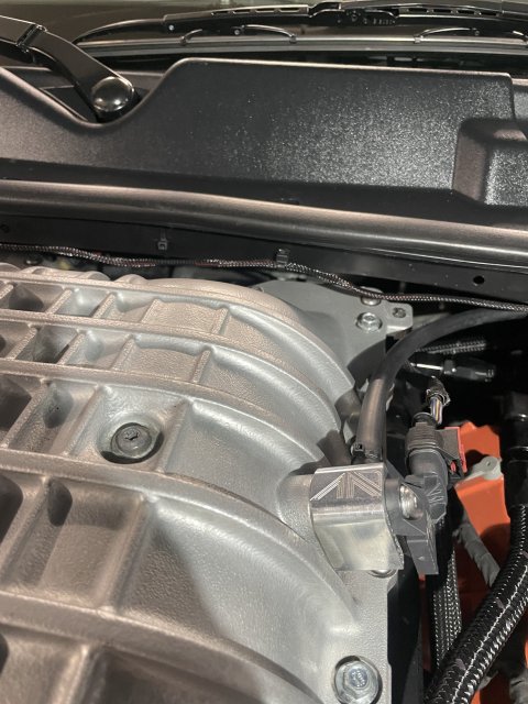

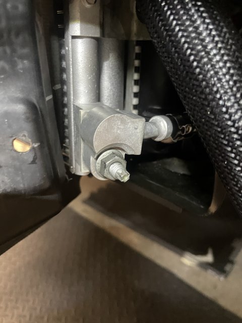

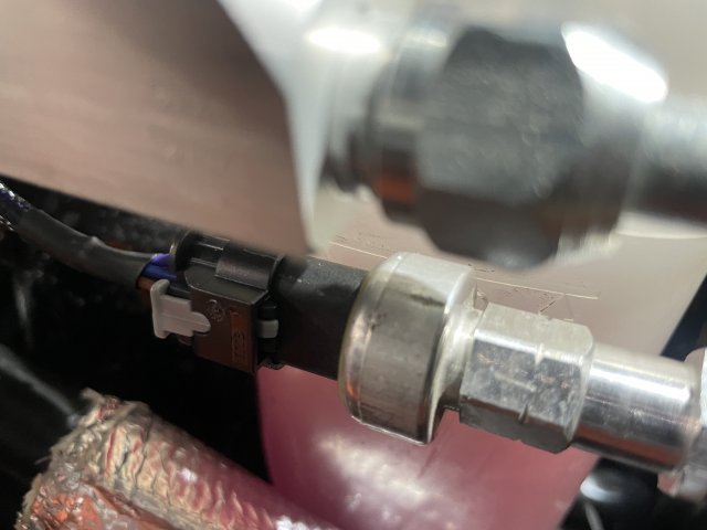

this line is used to extend the ac compressor pressure sensor that you will move from OE spot to up front
see the black cap in the lower right, thats the original sensor location. Wrench size is 14mm.
Move it to up front at this location.
AE1AEA7B-8CC9-409E-98A9-D3777D387916.jpeg BC32A1A5-870B-4D07-93F1-98856783ECD2.jpeg
Then use the extension harness.

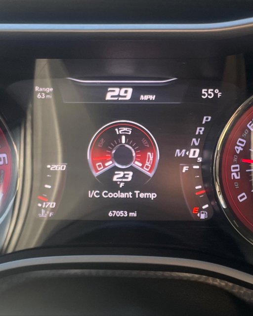

first time using the paddle shifters since she sent. Lets just say the pants were changed 😂. Downshifts, smooth. Upshifts, smooth. IC Chiller testing as well. With just the defroster mode she got to 30*. 🥶

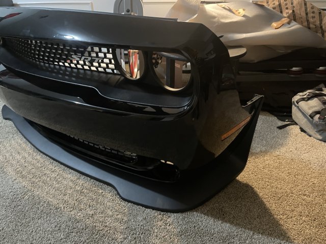

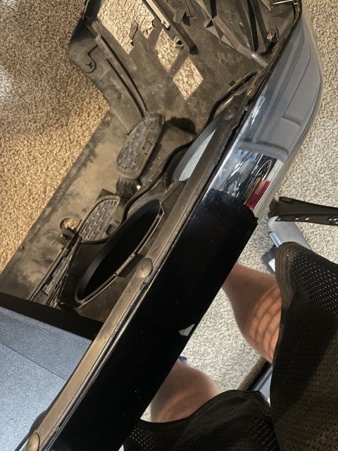

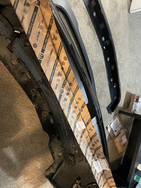

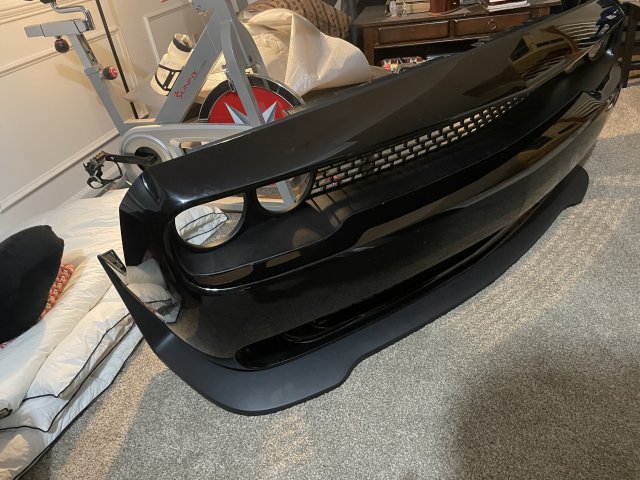

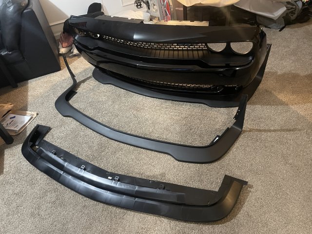

Decided that this evening I wanted to fix the plastics on the bumper. First stop the weather strip.
AE323B11-6670-4225-81E1-E1639B0A1D20.jpeg AB9AB326-906A-4017-B019-92D7010C318B.jpeg
came out great, should keep bullshit off the engine while driving

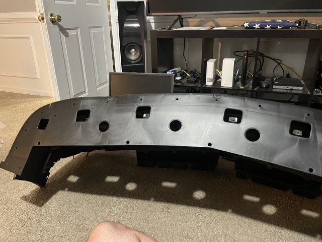

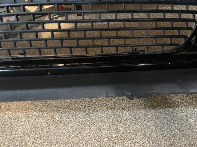

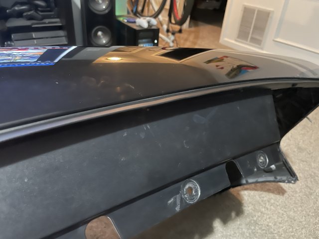

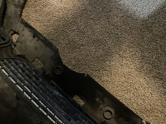

next up getting rid of the ugly ugly
E8591F98-E160-42C7-A437-7F0F2F6EF22E.jpeg 3611AB0B-E79D-46AF-BB20-0081739C9E9D.jpeg E4851954-ADCC-4875-B41F-3D1E40CBF620.jpeg
now to make this look decent again
17A1478C-7279-45C9-A1F3-41F5616A7097.jpeg F3865E1E-D353-4A2D-A1DB-8A595F0ACBFB.jpeg B6D058AA-334D-4362-8BF2-23B90533B02C.jpeg
Jackass before me used regular body panel inserts. i used actual plastic rivets, its rock solid now. Also have all new under panels as well.
Decides to clean up and refresh the front fascia deck lids

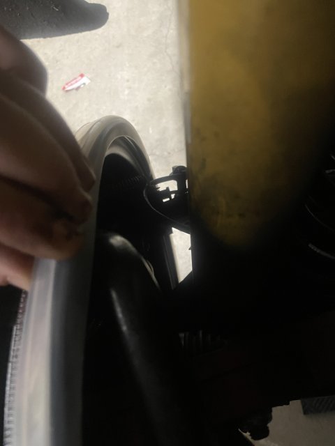

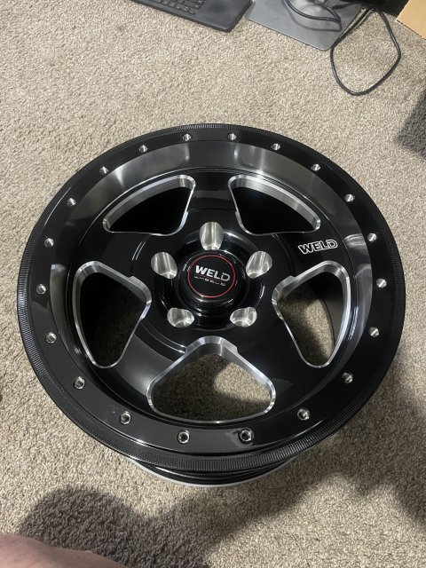

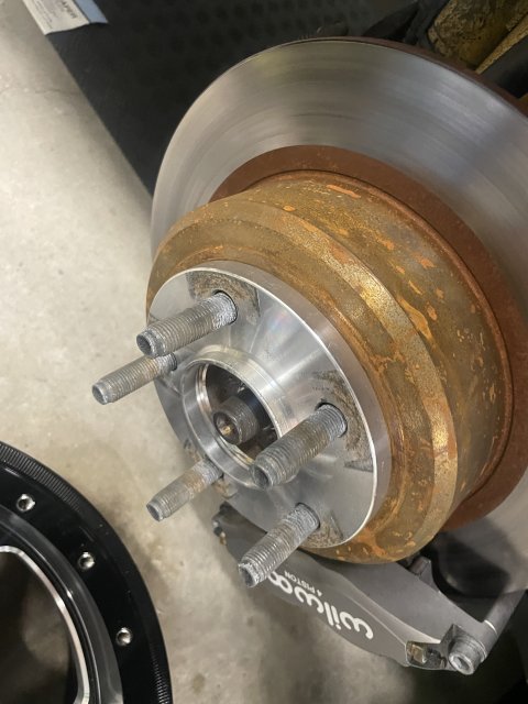

heed the warning!
without the spacer it hits, might just be suspension articulation 0694EE68-9368-4D88-8875-9E82781D876D.jpeg
Very very shiny…

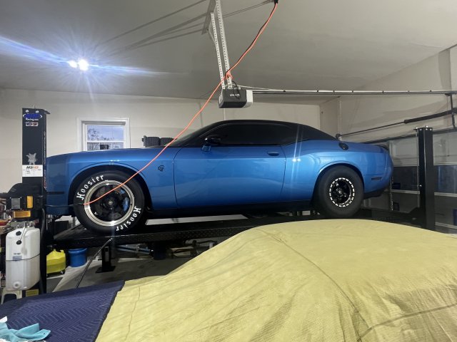

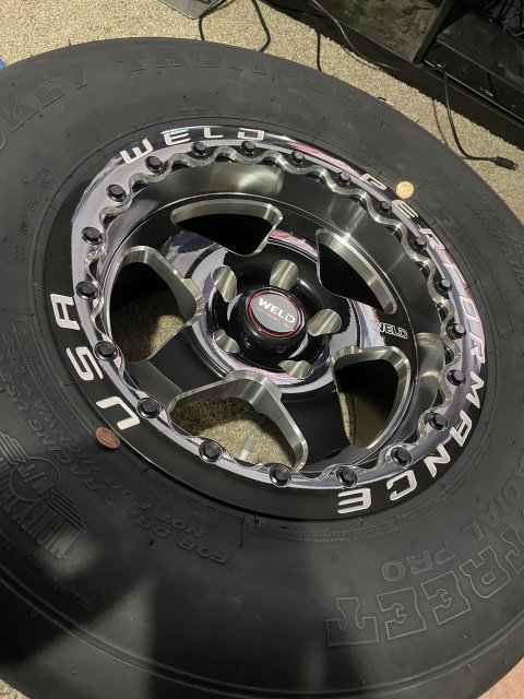

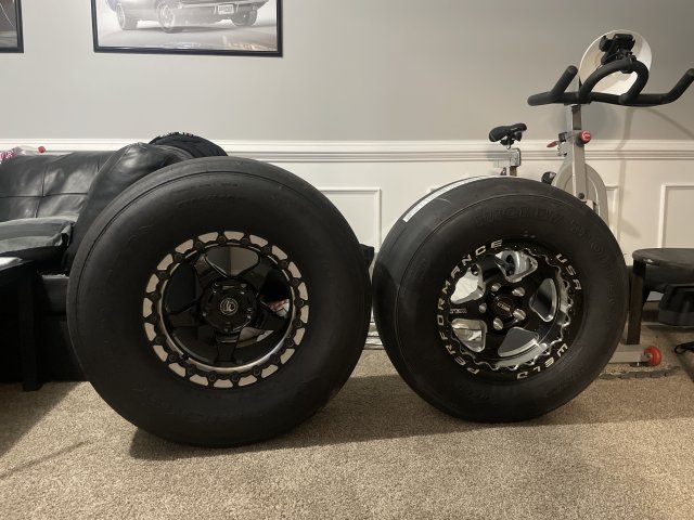

Hand start every bolt with a dab of anti-sieze. First go around, 5ft/lbs. Second go around, 10ft/lbs. Final go around 10ft/lbs again. EEC716D8-1CD9-4D75-A7A4-065E55C6EC5C.jpeg
On the left 295/60r15, on the right 275/60r15. Ones for fuck around find out, the other ones for small tire class racing.

Cmon! Step up to the 315/60/15’s! Or at least the 29.5x10.5x15’s
