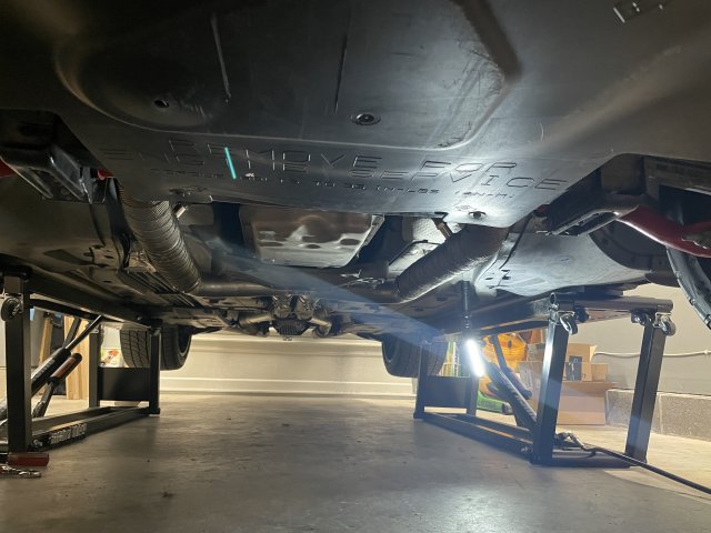

FD334C3F-703E-4089-8476-2F180307A716.jpeg F1811EB7-53C1-46E1-9BD4-419B111C9F9B.jpeg 32390895-BF40-4DE0-891F-06BBB36E2BD6.jpeg 7B056F00-DB13-49DD-BB51-1640A5AEE038.jpeg

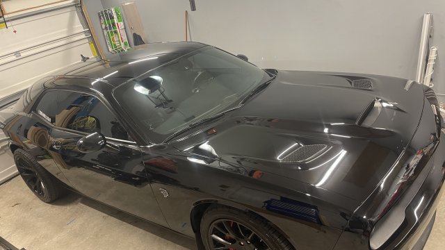

Q16 ready! Todo: remove COT in the tune, turn back on active exhaust for daily and limit the timing for 93. Been driving on hot tune…
I literally sat in my garage and stared for an hour after picking her up from the paint correction. Its like a different car now.

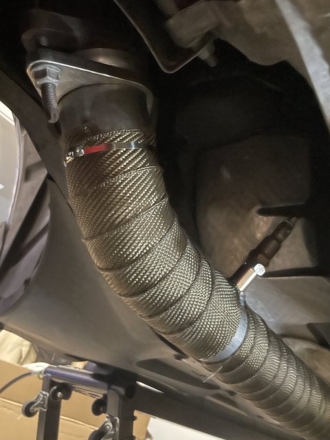

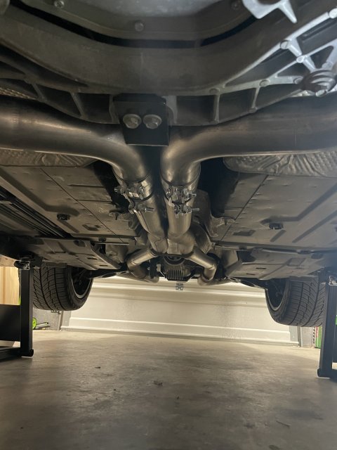

How did the pipes fit? And sound nice ?

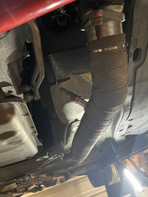

Any worry with 02 sensors ?
Fitment is good, clamps suck. The 3” clamp is a pita. Havent started the car yet. Got done at 11pm and didnt want to piss off thr neighbors.
Any worry I’m 02 sensors ?

Fitment can be funny with them. On my Daytona they fit good. On the hellcat I had to keep adjust them till I found a spot they leaked the least amount. Maybe you will get lucky but what I had to do was get under the car start it, shut it off adjust it start it until I found the best spot. Also with the flange you can over tighten it easily which you will see it bend

The leaded fuel won't play nice with the widebands
no leaks, played with pipe till lip was somewhat equal all the way around. 22ftlbs on the flange and 37ftlbs on the clamps per factory specs. Going to give it a few heat cycles and check.

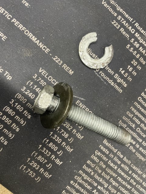

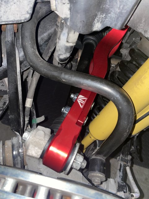

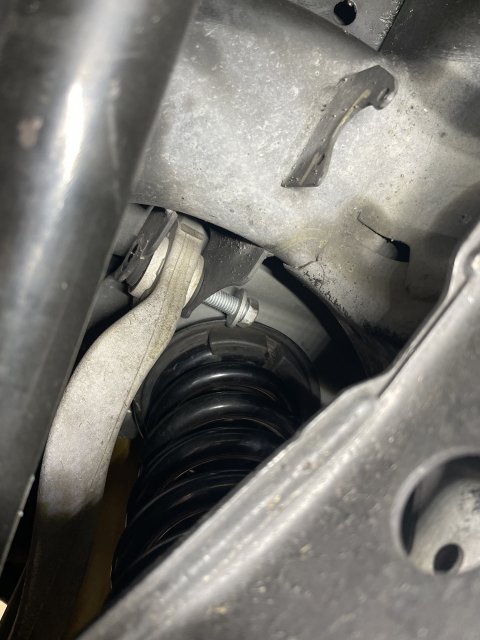

Very disappointed with how tonight went. On both sides this fucking bolt wouldnt pass the isolator cup housing.
wiggling yanking etc could sneak it past. The washer was compression fit so the threads couldnt pass. Problem solved.
DD5D4C5E-3162-4E34-B2AE-154826049DA5.jpeg BA8A8397-6E80-4179-B57F-53B996E8F96B.jpeg

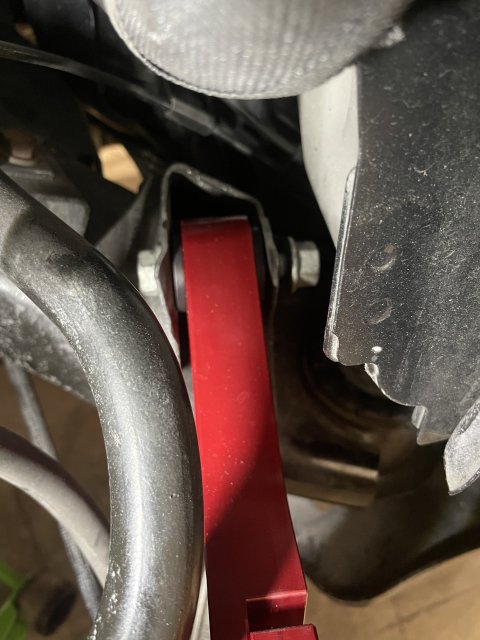

Only got the camber arms in tonight. Very pissed i didnt get more done.

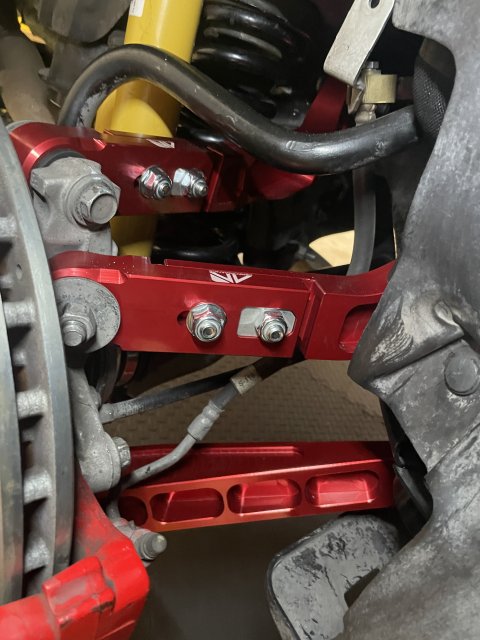

Checkout the bling bling.

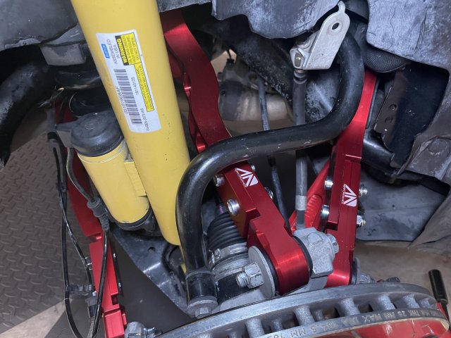

C3DDA511-8AEF-48F8-9522-364E9FA4E2E0.jpeg 86F30823-7B1A-4918-A080-F5A6712B70EA.jpeg 33301737-196E-4484-944F-DB8265FC9119.jpeg 75CBCF2D-48D5-44EB-956D-1ECF3287C662.jpeg
Fought me the entire time. Passenger side done. Drivers side tomorrow night, should be easier now that I know what im doing. Started with -1.0 tab after speaking with a lot who run this setup. Alignment this weekend.

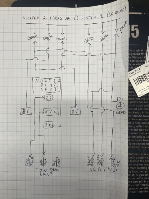

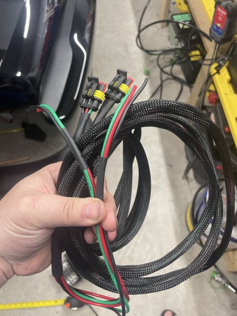

Killer chiller wiring diagram. Will digitize soon.

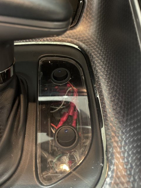

previous owner tapped accessory for me, thank you
made the harness to exquisite levels of protection
i hate working with lexan, prototype but its growing on me
evil mode activated
