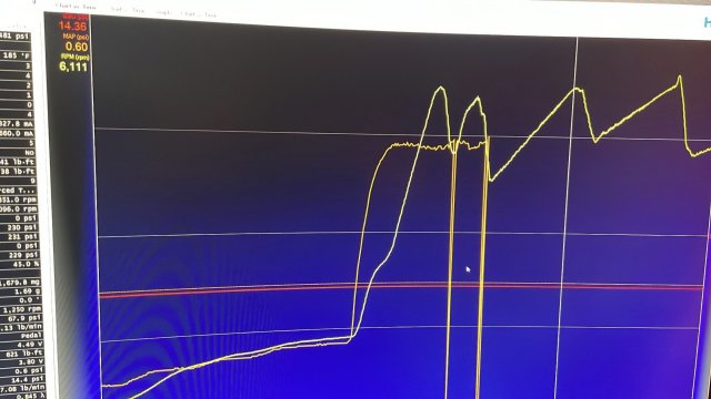

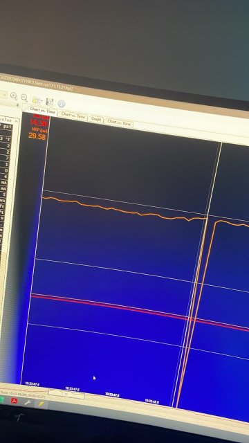

In other news I was checking all logs to make sure it was safe to start Speed Density tuning and I found that I was exceeding the stock oem Hellcat map sensor. The sensor would hang in till about third gear and yeet.
49F86E38-154F-49C5-8FD5-6E5ED2F9C0D1.jpeg 5EA8DAD6-42F9-4713-9374-83E9D609B378.jpeg
So my switch to SD is delayed till I replace all the necessary sensors. Could explain why ANN would just wig out and give me the red lightning bolts of doom.
View attachment 58803 View attachment 58804
Will the RE / Demons sensors work ?

Will the RE or Demons sensors work ?
I am sourcing four demon sensors. I will have look at the scale on the Demon tunes and place that in my tune.

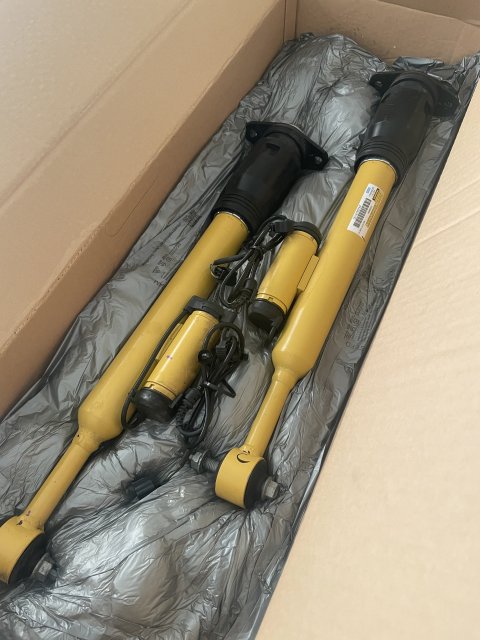

Got a set of take offs from a 2018 Challenger to see if this solves my click. Got them from Cleveland Power and performance ebay page, they had 30% off that day. Cost 220 out the door.
