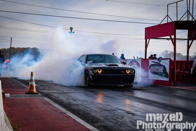

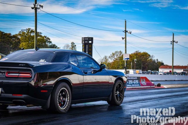

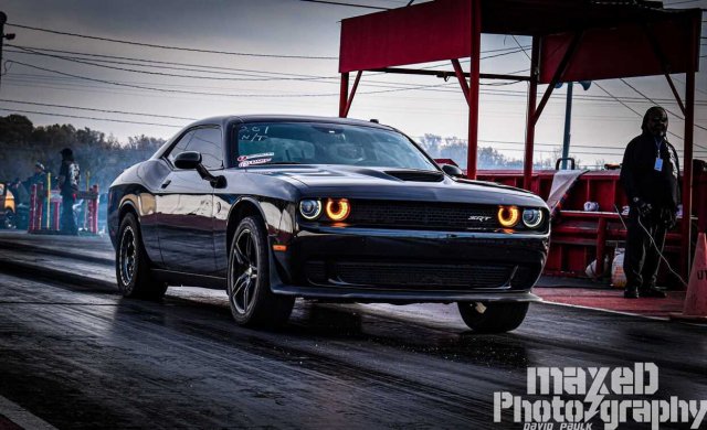

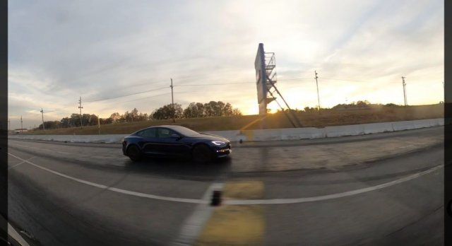

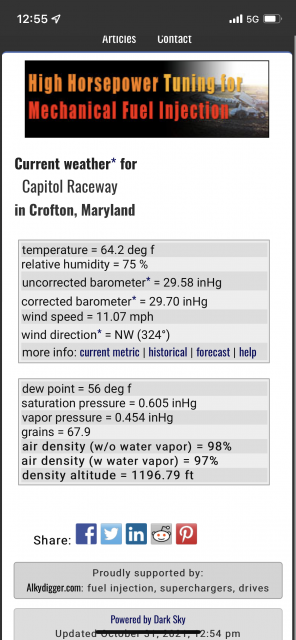

So today I went to the track just to have some fun. Didn't go with skinnies on the front. In fact I sold them to a good guy, first responder and I am off the RaceStar bandwagon, they work wonderfully, just tired of the shank style lug nuts. Setting the stage. 3/4 tank of gas, full 20" tire in the front, bang off gears and yet I set new personal bests!
Best 60' 1.42, best 1/4 9.84... Without even a proper setup. Was kind of kicking myself in the ass for selling the skinnies and not having a lighter car. Nothing I can do about that, but I had fun. I also sent a Tesla into the shadow zone, someone said they were fast, not buying it... 🤷‍♂️
Have the 360 footage coming soon, till then enjoy these bomb ass photos from a great photographer. My car is sexy...

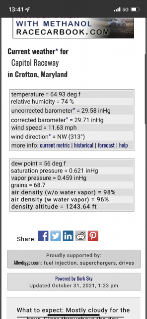

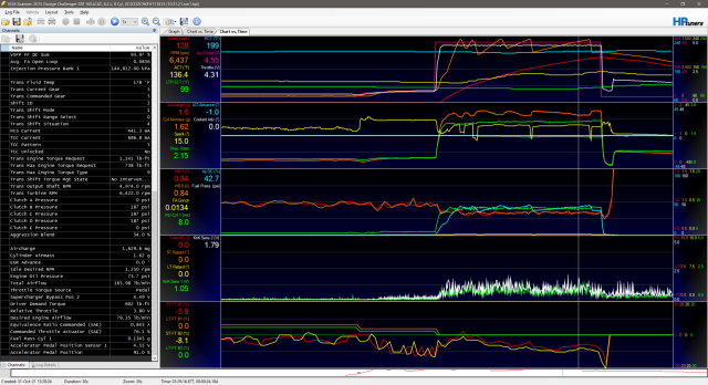

@Speedy! thank you! 3.09 gears do that, feel like cheating, lol... I'm having problems with the trans though. It is banging off rev limiters in random spots. Can't tell if wheel slip or I'm not giving it enough line pressure. All logs attached. I was looking at the tune that was written and it seemed like it was corrupted. So then I re-wrote it to where it was on the MHSH event and it was still banging. Considering it is great air, she's eating maybe I need to command the shifts earler. Test N' Tune, Test N' Tune!
