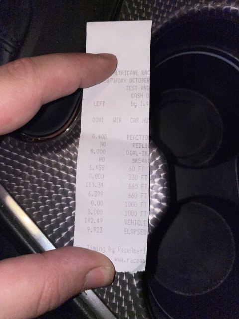

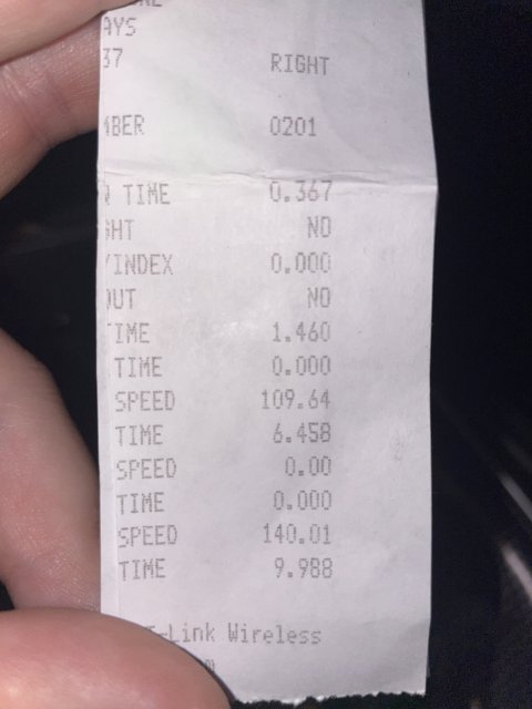

She is dialed in. The 60’ was the plan for tonight. I love pro tree. They were running a .500 tonight. Last run had a great 60ft. Track was sticky! So sticky a drive shaft came out and hit a guy. ;(
I think Im on point to be a 10.00 car for the mhsh. Ill put the seat back in or add gas 🀣

Man your local track is really prolly getting to know you. Every weekend it seems like. Good work. Have to feel good to pull out so many 9 second passes.
If 9s were easy everyone would be doing it.
Have you put any thoughts on what you’d have to do to run 8s? I have. I need a short block πŸ˜‚

Thats a great 60.
Are you running MS109? Or What?

You know, I'm almost wondering if your track has the 1/4 mile timer off a couple feet. Those are really good 60' and the MPH as well. That would be a high 9.7x in my car at my local track. My 1/8 mile times are a hair better, but all this time it could have been where those timers were set.
P.S. You can't tease me about my pro tree RT anymore though LOL

Hard to say. Remember we had almost identical time slips and I had 1mph more and you went 2 tenths faster.
I wish had that log still to know but I’m sure there was knock. For whatever reason In the log I double clicked record and didn’t notice so I didn’t get the pass.
regardless he is moving with that mph.
But I do agree with that 60ft and mph his et should be better

Hahaha, yes I can, I usually cut .1 on the pro tree. Anyway the logs never lie. I think I'm hitting torque management issues finally. I am doing a deeper dive but right now in the logs either the ETC A/B kicked in and said you are making way to much torque, close TB or I banged off the rev limiter, which not going to lie, it felt like it was falling over from 1-2, just not a hard shift. I am going to do a deep dive in the current revision and see what I have set for those limits. If the OSS speed is not set high enough, I'm going to raise it a smidge to move it out of the way and Torque MGMT be damned!

I saw in my logs that the TB closed from the 1-2 shift. Either I banged the rev limiter (most likely) or the Torque MGMT kicked in. I'm doing a dive tonight in the log/tunes. I'll report back soon.

I had to play with the rev limit and 1-2 shift point on mine to dial it in. Commanded shift of 6400rpm doesn't always equal 6400. Things are happening real fast on the 1-2

I evaluated logs from 10/1 and 10/8. 10/1 was the first time I was in the 9's and I didn't review the logs till today (bad on me). It looks like for all the runs I met some sort of limiter in the first to second gear shift. I have attached all six logs to the post just in case someone else wants to look at them. So I can't tell if Torque Management (TM) was at play or if the car closed the throttle body to help make the shift happen. Here's some data from the logs.
  • 10/1, run 1, 1->2 shift: 6829
  • 10/1, run 2, 1->2 shift: 6882
  • 10/1, run 3, 1->2 shift: 6576
  • 10/8, run 1, 1->2 shift: 6878
  • 10/8, run 2, 1->2 shift: 6787
  • 10/8, run 3, 1->2 shift: 6764
The OSS/RPM shift schedule is set to 6594 (engine rpm) for the 1->2 shift in all of the aggression patterns that matter to me. Although scheduled shift vs when a shift occurs is another thing like you said @Speedy!, so for the next plan of changes to my tune I have th following in mind:
Engine side:
Update Maximum Flywheel Torque by 10% across the board. These numbers have been updated from stock but I think they are conservative.
TM Disable Electronic Throttle Cut A/B
Transmission side:
Moderately adjust the Main Torque Intervention tables and adjust all negative values by -25%. This is probably the safest on the Hellcat HP90. Do it all for Normal, Perf, Sport, Max.
Adjust the Max Torque Limit table to match the Gear Max Torque Limit Normal, right now they do not match and the latter table has a higher value (which I will be keeping).
Adjust the shift pressures slightly, +3% in the oncoming clutch ramp tables.
I don't know if increasing the WOT shift points will help, I think having a little more pressure to make the shifts at WOT would help more than raising the shift points. Does anyone know what is the highest safest shift point in a HP90 to date?

IMHO, those shifts are perty high.

Took a peek at your logs. You're 100% hitting the rev limiter on the 1-2. Take a look at the PID "Throttle Torque Source" in your logs and you'll see it change from "pedal" which is normal to "rpm limit" above 6800 RPM. I personally wouldn't shift it that high.

That's what I said too. Your speaking from experience.
Trying to get every .01 is not worth a engine, at lease to me.
