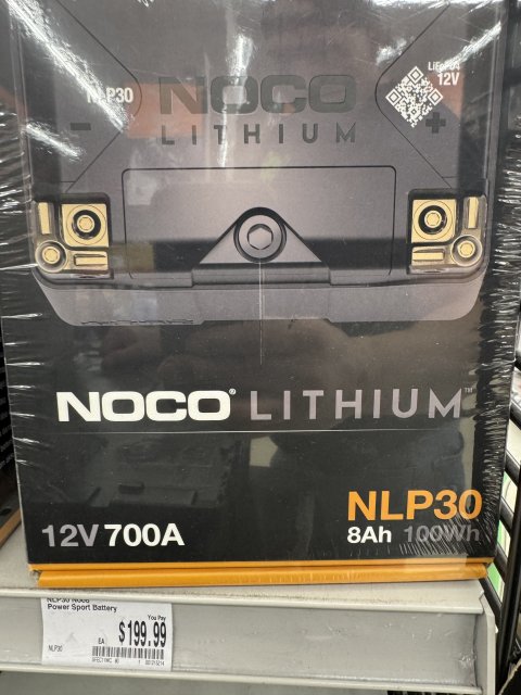

Saw they have a 1600cca and a 1300cca
Is the 1600 CCA worth the extra money?
The speed the 1300cca spins the engine over, there is no reason for the 1600cca.

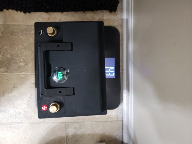

We have a new scale and it has been pretty good. For some reason with the battery I'm getting 13.8 14.3 and 14.5. I weighed a tire this week at 15.4 and weighed again today at 15.4. Then tried a few more times and had 15.2. The tire is the m/t 27×6×17 et front radial

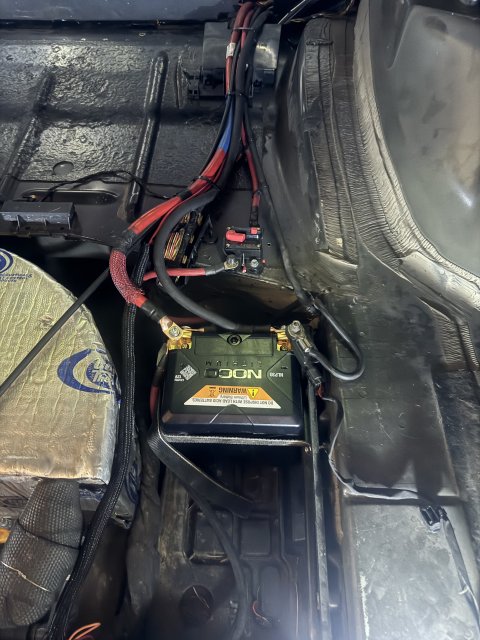

I use this one. Zero issues so far. Just have to keep it on a trickle charger if I'm letting the car sit over a week or so. weighs about 5lbs.
