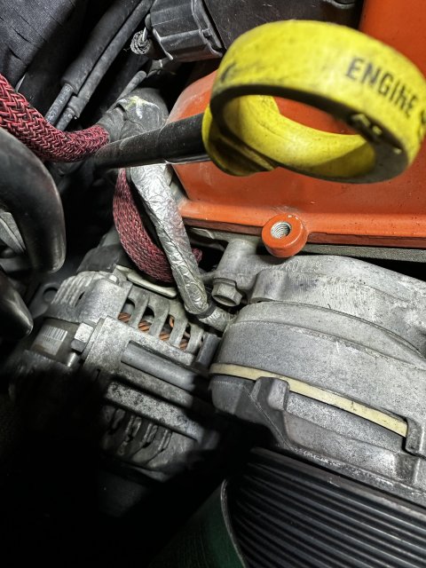

Can’t move the alternator/coil wire harness because on the challenger that sensor that’s behind the alternator is in that same loom and splits right at the end of the valve cover so no play. Had alternator off before, not doing that again lol

That engine compt.looks like ya drive it back and forth to work through the Bonneville salt flats....:eek:
Yes, some people actually drive their cars and can take pictures of them ;)
60,956
212,938
Thread Starter #32
Salt from the ocean in the air? I drive mine daily and it doesn't look like that
8,667
7,636
You don’t take yours off-road?
31,174
65,699
And the rest of us...actually CLEAN them once and a while :rolleyes::rolleyes:
31,174
65,699
Now I'm anal bout my toys...(detail in and out..and underneath)...even my DD gets washed every day...(sometimes twice in winter)...to me..even if you washed the outside...that engine bay is like puttin on clean socks...on dirty feet...I mean like WTF Holy Guy..:eek::eek::eek::eek:
