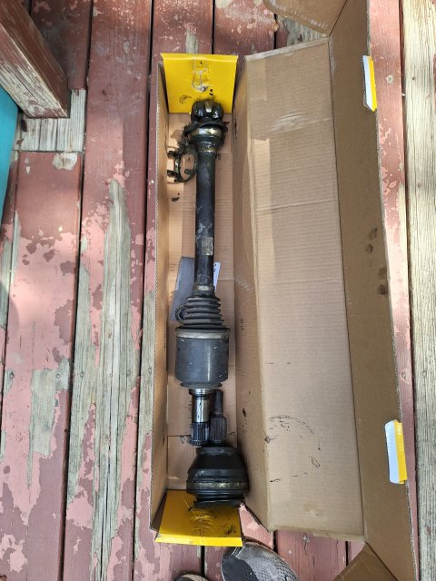

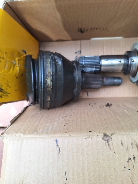

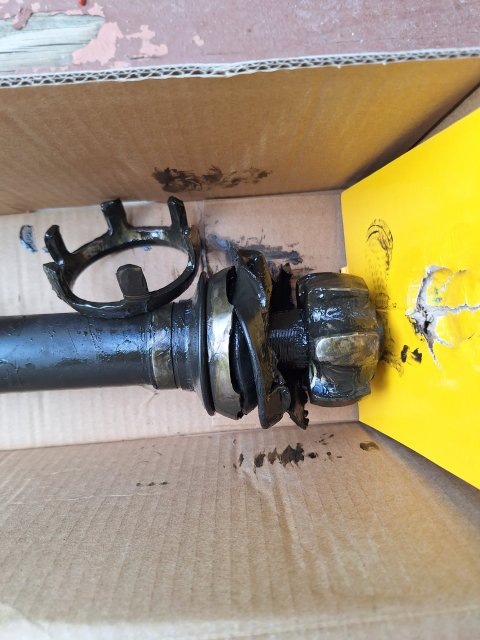

Picked up a vibration during sick summer.. then promptly Chucked the driver's side on the way home during a pull. Outer CV exited the chat in epic fashion. Never found all the internals. Looks like it sheared right off at the base of the cup? Also...diff splines were starting to twist. Days were numbered regardless.
51k miles. 42k modified. Hundreds of hits. It owes me nothing.
Redeye?
DSS?
GForce?
BadBoyz?
Car is not lowered and never will be. I do not autocross. Drag racing and Drag & Drive only. Lots of miles. Lots of launches. Great to absolutely Excellent prep.
F for the stockers. You will be missed. Thank you for your service.
