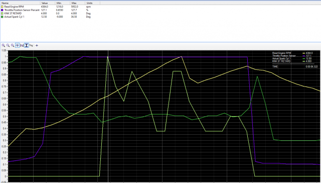

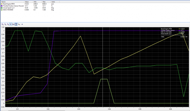

I went and found these logs from some summer street testing back in the day. This was June in TN so figure 90 degrees and humid.
First log is on Shell 93. Knock all through the WOT pull in 3rd gear.
Added unleaded race fuel to bring the octane to about 100 and re-tested. Almost zero knock.
