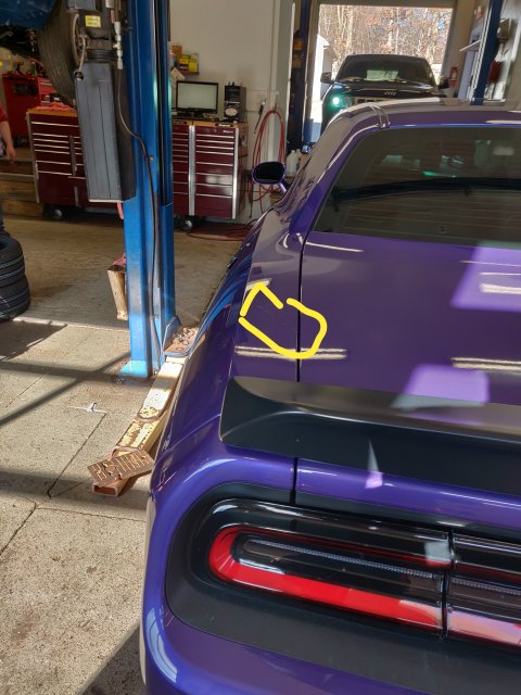

This gets me thinking as I have this odd paint blemish on the top of the driver side rear quarter panel, definitely under the paint but also raised. Looks like a catepillar died on the car prior to the paint job. When I had the PPF done, the shop asked me if the car was ever in an accident and resprayed but sounds like poor quality assurance from the factory. Does your blemish look anything like this, zoom in to see it, this is the only picture I currently have:
That's a LONG caterpillar!!!
Yeah, right. Is that what the poor paint job looks like, that other forum members are speaking about? No pics of any other bad paint jobs on the forum, only people talking about it.

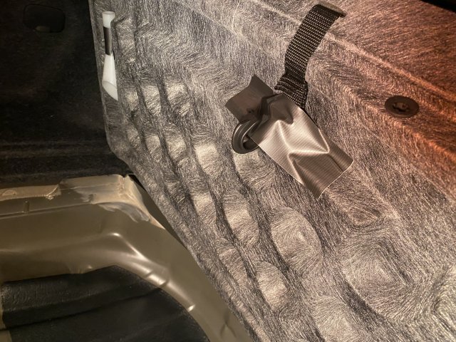

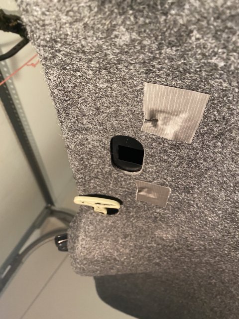

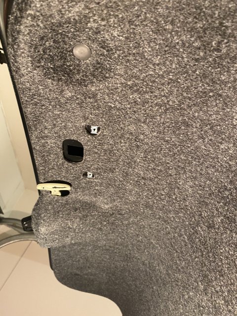

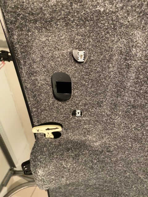

D5889406-36B1-481A-8D8F-226D5D0648DE.jpeg 4C605F50-D757-4F79-BE40-209E5F625F55.jpeg C6C4FCC6-E860-4215-A4F0-341911EDCDD3.jpeg Found it! Had my dad lay in the trunk when I went over bumps.. it’s the metal retainer screws. They are under a little plastic piece. Also I taped the emergency latch and the latch under the trunk.
