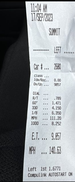

Thread Starter #179
Chiller worked it’s magic. Pb on 60’ and et by a little lol. Car is very consistent when it hooks. They had to scrape the track for an hour because someone blew their diff at the line. Shook wheels twice. These passes were clean IMG_1894.jpeg IMG_1902.jpeg

Thread Starter #180
Yes, I’m slow. But I’m upper pulley, intake and e85. Not too shabby. Can do better in the launch, that’s just stabbing it on green
