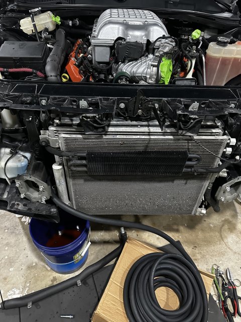

Hose came in. Decided heat exchanger is getting plugged off completely. If I change my mind, I’ll have plenty of hose left lol. Keeping the bugs on the condenser, adds character

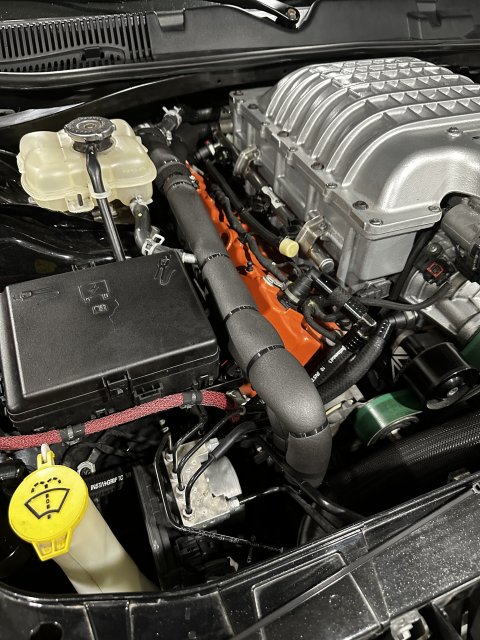

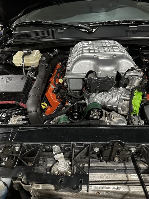

Thread Starter #44
Insulated good enough I’d say

Are you guys wrapping (insulating) all of your lines (too hot line included) or just the bottom cold line going into the supercharger?
I insulated everything including the pump housing.
7,878
6,742
Thread Starter #46
Oh wow. Do you know what the stuff is they use to cover the chillers/aux tanks? They’re rubber insulation in sheets? Looking for some of that

This just reminds me I need to re-do a bunch of mine.
One thing that Allpar didn't do was tuck it tight away from said alternator pulley. Oops. Lol
7,878
6,742
Thread Starter #48
Really? Did the alternator pulley chew it up?
7,878
6,742
Thread Starter #49
I also used the more expensive wrap which is smaller in diameter and bends/molds easy
McMaster Carr has adhesive backed foam insulation sheets, I used the 1/2” thick stuff
