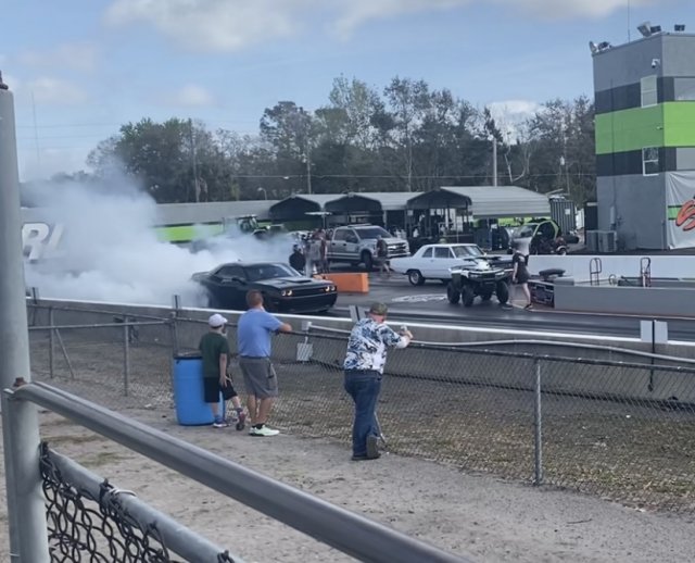

With radials there’s really no need to you’re just supposed to clean them off, I def John Forced it though
2 back to back 9 second passes, first passes in 4 years and with this setup. Right lane was amazing. Healthy burnouts each pass. 3rd pass switched to left lane and spun sideways half the track, had to get out of it.
Big burnouts work for me. Not sure who came up with the clean them off stuff but see many spin that do that
Well that’s according to MT with their drag radials you’re just supposed to dust them off. I had success with the big burnouts, thought I was overdoing it though, but did hook for sure
you have to do what works. With a dust off there is a good chance you will bring water with you or not get enough heat in them. Sometimes they have a lake in the box, less is more. With a burnbox I can do it without water and would rather see that
