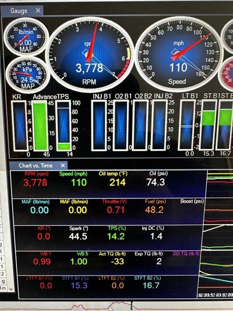

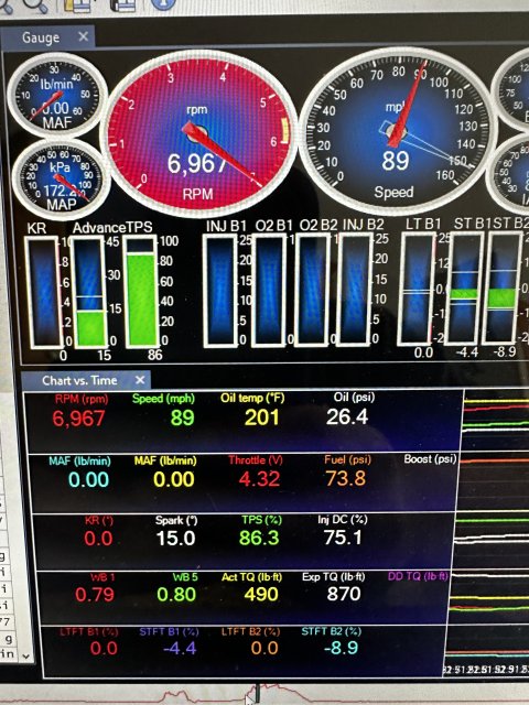

I know I change my oil every couple weeks. Mine on a pass I have low oil pressure threw 3 gears down as low as 29. When it pick back up it’s over IMG_6462.jpeg IMG_6461.jpeg 90.
So I can also tell you this my Buick with a rear sump when I throw the chute loss oil pressure on deceleration. I know I pulled the bearing on mine and still look great. I do use VR1 20w50.

7qts? Interesting about the rear sump pressure dropping on decel which makes sense - front sump you should gain oil pressure on decel

Yes 7qt. I may put a 11 qt on when it becomes available
